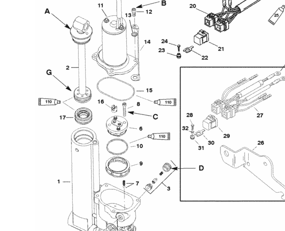

I have a 1996 30hp 2 cylinder 2 stroke motor and I'm converting it to power trim. I bought a power trim unit with a new motor really cheap that didn't work; previous owner gave up on it and bought a whole new PTT unit.
I took it apart and figured out the reason it doesn't work is because he lost the drive coupler between the motor and the pump... I spun it up with a drill and it works just fine.
I'm trying to find the drive coupler, it's part 16 in the diagram below but it isn't sold separately. Anyone have one in a box, know where I can get one, etc?

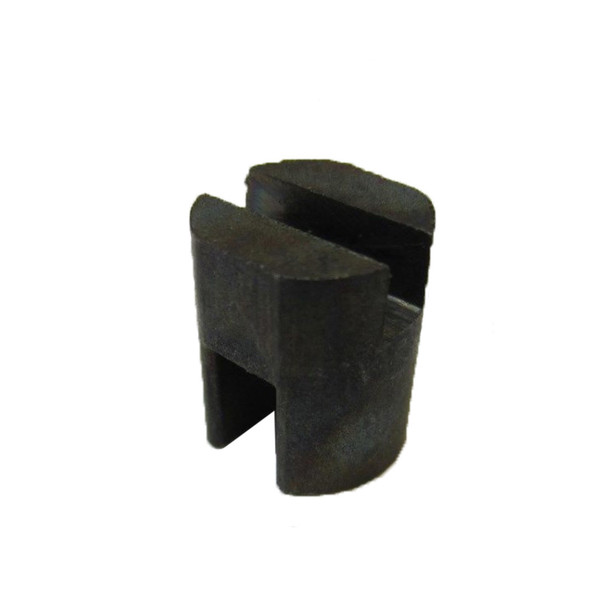

It looks just like the second one and i nearly spat coffee at the computer screen when I saw the price.
Thanks for the part number, I'll try to poke around and see if I can find it anywhere a bit cheaper.
Maybe also call some repair shops and see if they have one.
Well that was easy, took less than 30 minutes and this PTT unit works like it's new. It looks perfect, no corrosion, fresh water use its entire life. Dude sold it for $200 because he lost the drive coupler and declared it junk
