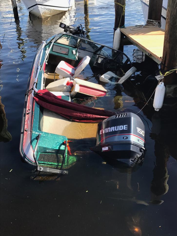

My mother in-law inherited a 1997 Javelin 379 FS with a 150hp Evinrude outboard early last year. The boat originally started fine & only had an issue with a little white smoke coming from the motor. Unfortunately, the day before taking the boat out on her first run, we had a storm come through & actually sank part of the boat (picture attached).
Thankfully we were able to get the boat out of the water but then, of course, it would not even attempt to turn over (this was this past September). After a little bit of work on the motor, I went over to their house today & the boat fired right up for the first time in almost a year! I was able to keep the motor running for over five minutes before shutting it off because there was consistent white smoke flowing out at the bottom of the motor, by the propeller. I do have a video of the smoke, but cannot seem to upload it to this site (I can email the video, if it helps?).
