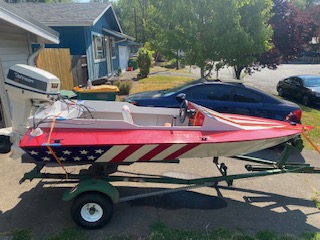

However it is a lot of weight for the back of my little boat and it porpoises pretty good. I thought my enormous girth (think retired defensive tackle) would combat that. But I can move the gas tank and battery way up front and slap on a whale tail and probably trim tabs and be good to go. As soon as it gets on plane, it just launches like a rocket.
Here is the Bullet
