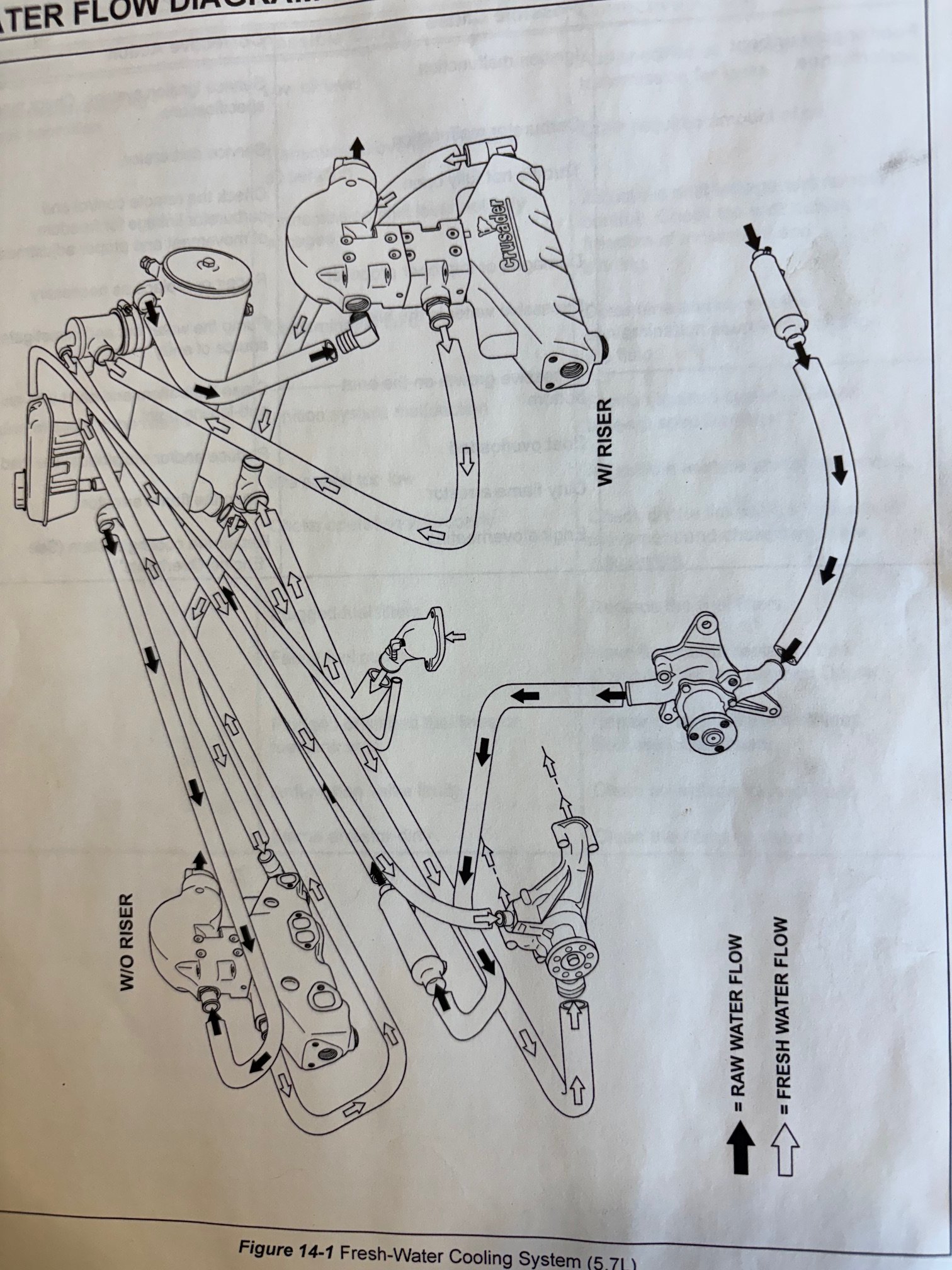

The manual has 2 pictures for fresh water flow. One is "with Risers" and one "without Risers". The only difference is an approximate 4 or 5" piece between the manifold and exhaust elbow. My engine does not have this "riser". I had thought the elbow portion was called the "riser"...

Also, as education for me... The risers have water jacket ports to pass to the manifolds. If the manifolds are fresh water cooled, and the risers raw, is this what the "cut off plate" does for close loop cooling? I see those parts for Crusader risers on the web.

On the block off (cut off) plates, yes - they keep the coolant and raw water flows separated...You description is a bit inaccurate but you got their purpose correct...
Looks like they mad a mistake in that Crusader diagram…they have coolant exiting the manifold on the right side of the picture (with riser) but none going in as it should be entering the bottom port and exiting from the top port…
