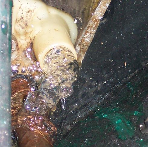

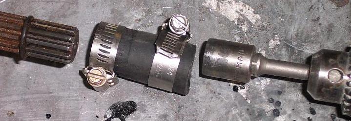

Run the lower unit with a drill and see if water shoots out of the pump.
