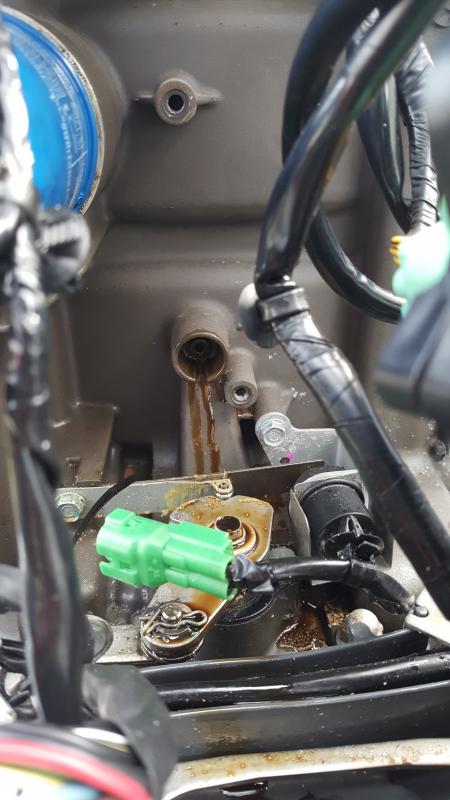

Honda BF225 leaks oil when trimmed up. leak coming from a hole behind the fuse box. what is the purpose of this hole? how do i stop it from leaking when trimmed up? please help. thanks in advance.

The black component bottom right in the photo is the neutral switch I believe. But pulling up the parts page for "Shift Shaft" (see link below) where the neutral switch is listed, I see nothing there that looks like it fills that hole.

The blue item top left, appears to be your oil filter. It is depicted on the parts page labeled "Crankcase" (in link below). Again, like chawk_man, I see nothing listed there that seems to fill that hole!

But, it is obvious this is sump motor oil. It looks as if a plug was there at one time. Also, just to the right of the leak looks to be a threaded bolt stand.
If it were mine, I would plug that hole with a rubber stopper or a cork. Then I would fashion a clamp to hold it in place using that bolt stand (If that's what it is) to keep it there. The clamp would look like a miniature open end wrench with a small hole in the handle. You could do something like that to keep the mess to a minimum until you can figure out what goes in there.

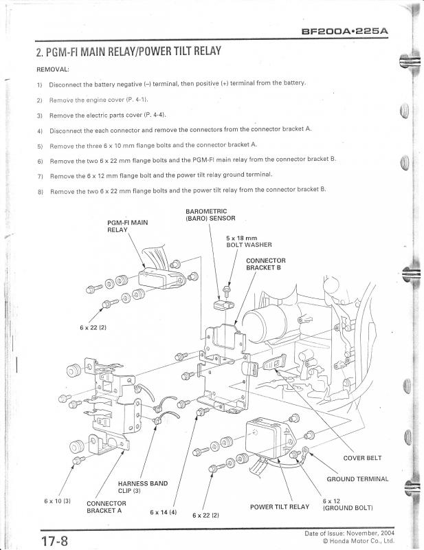

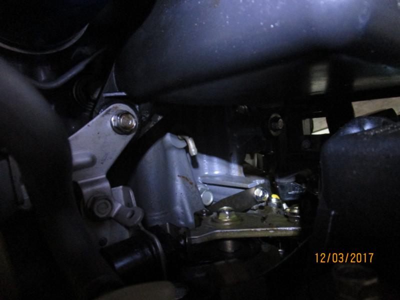

Jimmy and all - I'm in the same boat. Been thinking about what in the heck goes there. Went through several chapters of my Helm shop manual and don't see anything there. If I get time Sunday and no one has solved this yet, I'll get to my boat and take off some stuff and see if I can eyeball it. Not sure I can without major disassembly.
On second thought, I doubt if I can get in there without major disassembly. See the attached file, if I can get it to come through....Electrical brackets.jpg
Yes, it looks like a can of worms even though I can't make out the component names.
Is that the main relay and fuse panels?

I can see behind the black plastic cover, the other "fitting" where the oil is dripping out of on the 225 is not there on my block.

OK I have the same problem with mine. And if you look at it closely it looks like a cup on it's side with a cut out wedge on the bottom to let oil drip out. I believe the top of the cup would be against the back of the bracket that holds all the wire connectors in place.
I'm thinking the same as some of you have mentioned, that it may be a crankcase pressure relief that may have something in the way and not allowing it to close. I'm going to see if has a spring load ball bearing or something that is not sealing.
I'll get back to you all. Or has someone already figured out why this is leaking oil ??
On my 2004 Honda bf225 outboard boat motor, I seem to have an Oil leak on my front crankcase cover. It's coming from a factory made hole behind the wire connectors hold down bracket plate. It's like a half inch cup with a small slice taken out of the bottom. It has a raised eighth inch hole in the middle. How do I get that to stop leaking ?
