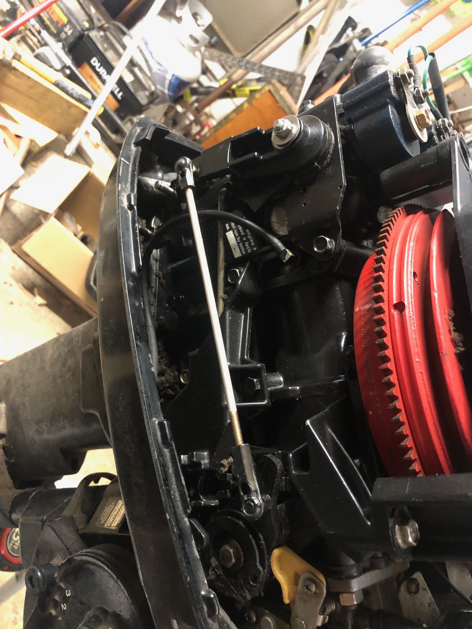

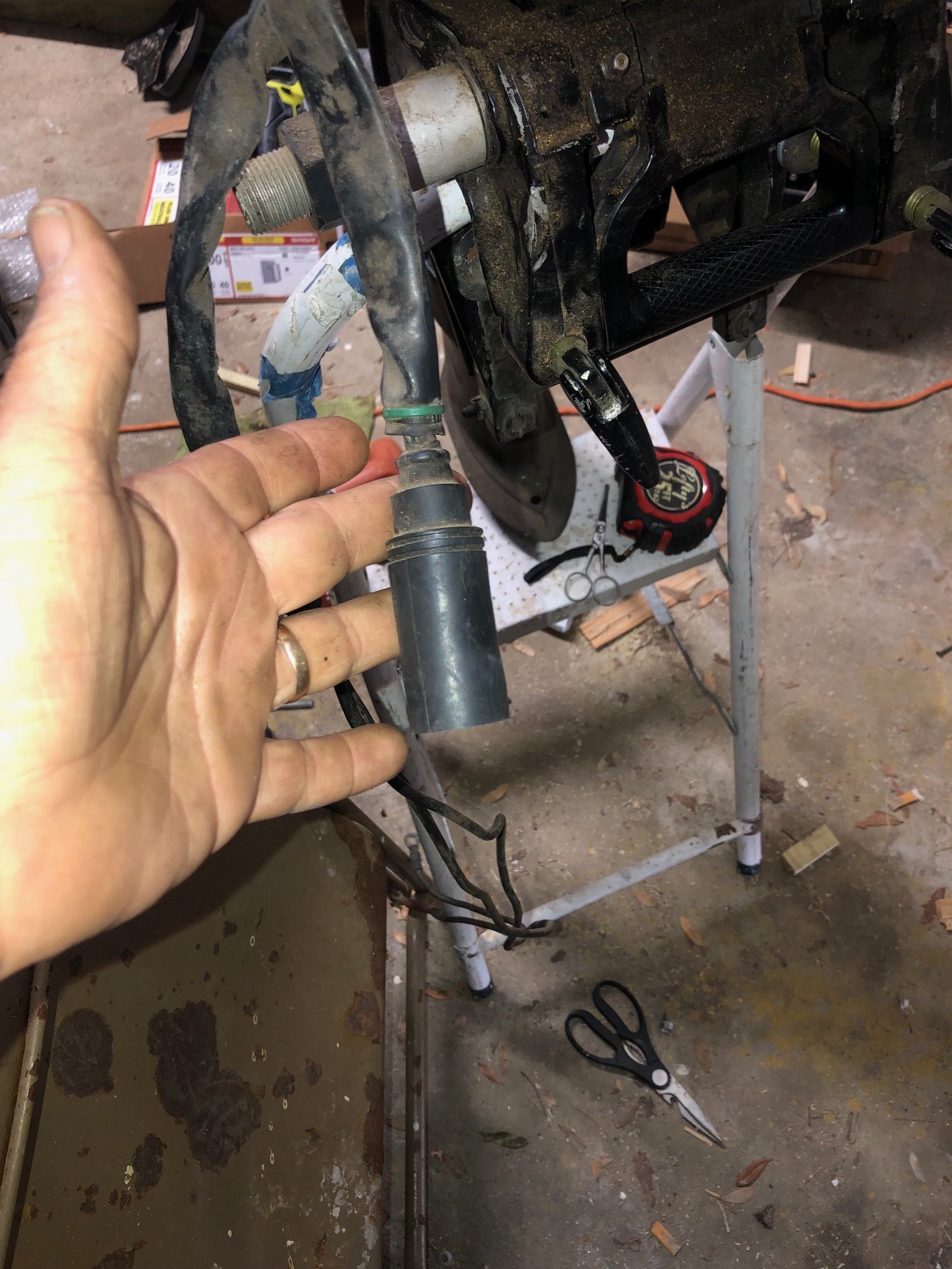

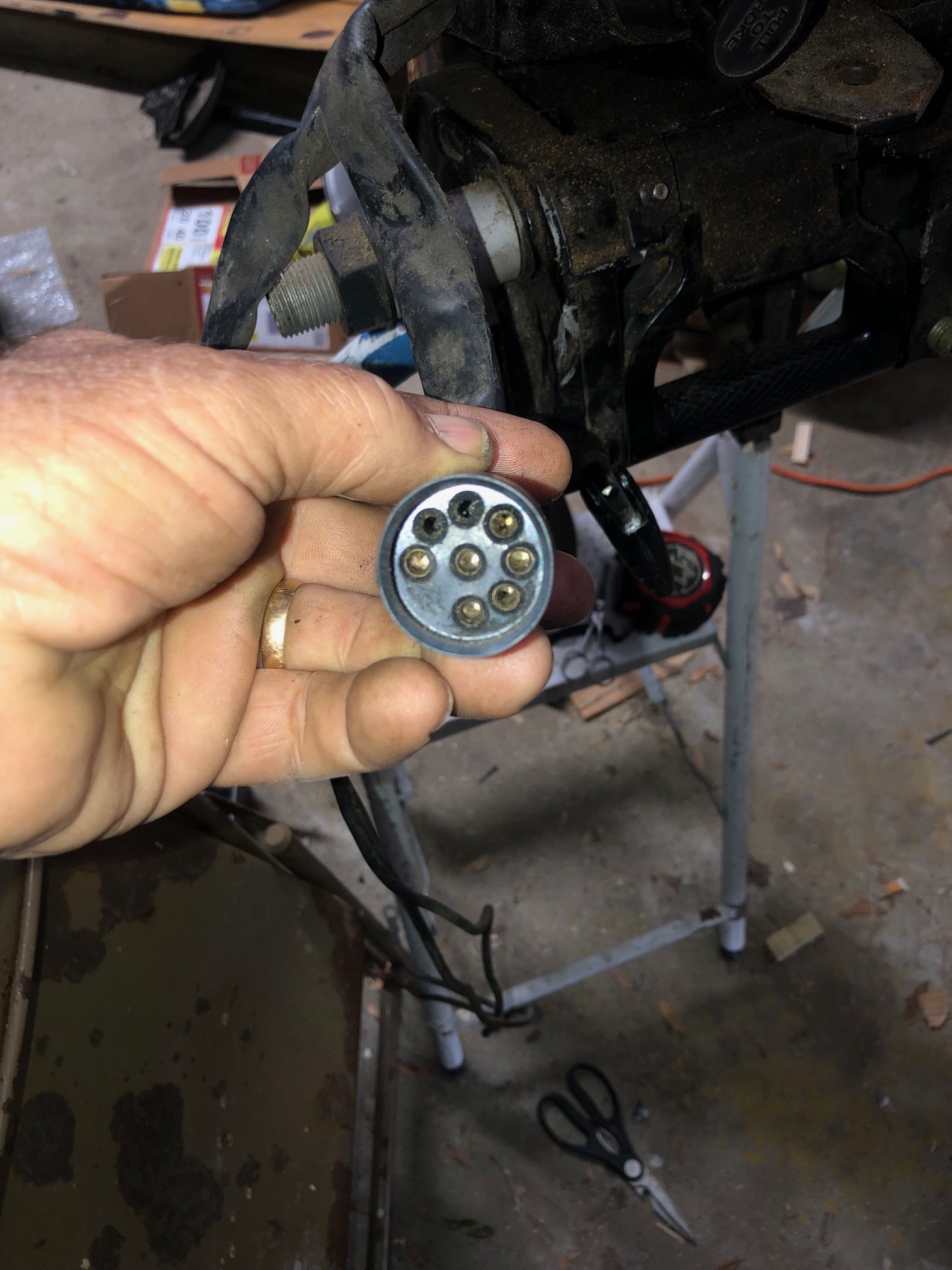

I recently purchased an older 9.9 Mercury tiller handle electric start motor. It was used as a trolling motor on a pontoon boat. The owner had it set up with a control box. I'll be using it on a john boat, so the tiller handle will be the controls for me. The tiller handle twists, but doesn't seem to be in any way attached to the carburetor or shift controls. It only seems to have the kill button on the end and nothing else. Did they make them like this, or have parts just been removed? Also, I have no idea where the start button is. There is a wiring harness for the battery connections and another wiring harness with a round connector with about 5 or 6 holes for round pins to plug in. Can this be converted to word as a standard tiller handle with a start button somewhere? Serial number 0B390028
You need the kit to convert them electric start to a push button set up. Put up a pic of the right side of the motor. The tiller and remote setups are not the same. Are the cables in the tiller?

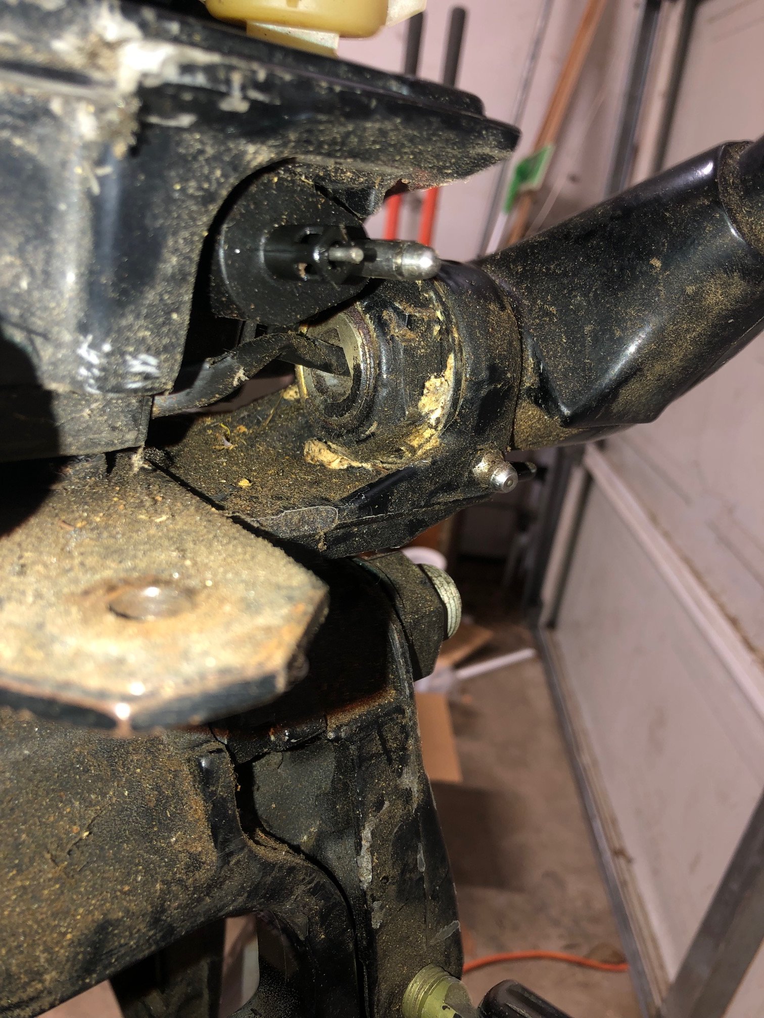

The only thing coming out of the tiller handle is wiring for the kill switch. Also, can you tell me the year of this motor from the serial number? I can't find anything but parts catalogs by typing in the serial number. Thanks so much for your help.

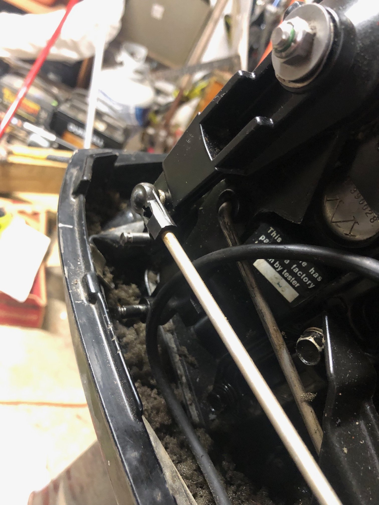

I took the tiller handle off and I see where I simply need to order cables to connect to the shift and throttle arms. Knowing the year model of this motor would be great, but can't find any info for this serial number.
You need to do a parts look up. Ebay will be your friend. It looks like all the linkages you need are not there. You will not be using that plug. What is the serial #
0B390028
The tiller handle on the inside end of the shaft has grooves for cable hookups. Pretty sure I found the short cables that go from the tiller handle to the appropriate linkages, but want to know the year model to make sure I get the right ones. They seem to come in different lengths. I also found a starter button, but I can't find anywhere on my motor where it would go. Information on exactly what motor I have would be great.
