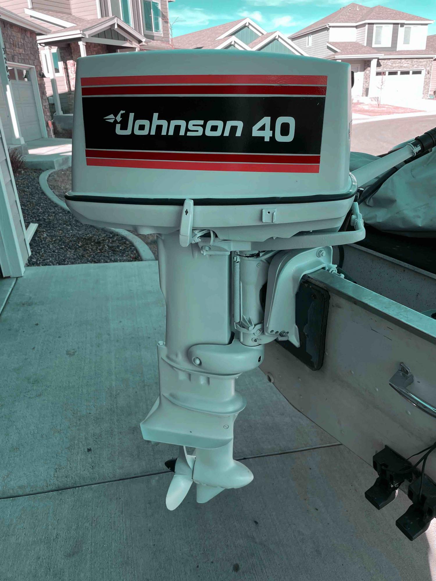

Here are near perfect matches for Johnson whites in base/clear finishes. These codes could possibly be crossed over to other finishes like DuPont or Pittsburgh, (I believe Nason paint is a subsetary of Dupont). If you don't want to use a clear over, then I would recommend an acrylic enamel like DuPont Centari. I like using a clear over to protect the decals. IMG_20211119_221616436_compress47.jpg

Finished repainting my 1982 OMC Military today. When I purchased this on an eBay auction it was 100% Olive Drab. I covered over the olive drab 15+ years ago with a rattle can but the paint job was failing. I used your formula and clear coated everything when finished. I think it looks beautiful!
Thanks for the formula.
Bruce
Beautiful for sure. Great job. Next time I'll hire YOU to paint for me. I'll be doing a 1973 40 Johnson LS tiller. What kind of a spray gun do you have?
Thanks, Tim, for the kind words. I bought a $15.00 gravity feed spray gun from Harbor Freight for this job. It has a small cup but I didn't use a little more than half a pint for the whole job. It sprayed evenly and was easy to clean. In addition, I used a self-etching primer and clear coat from O-Reillys. I won't be using the boat for a few months now so the paint should have plenty of time to set up.
