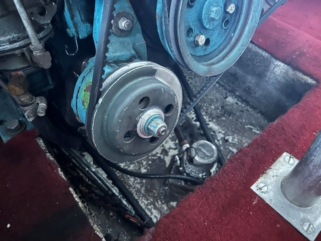

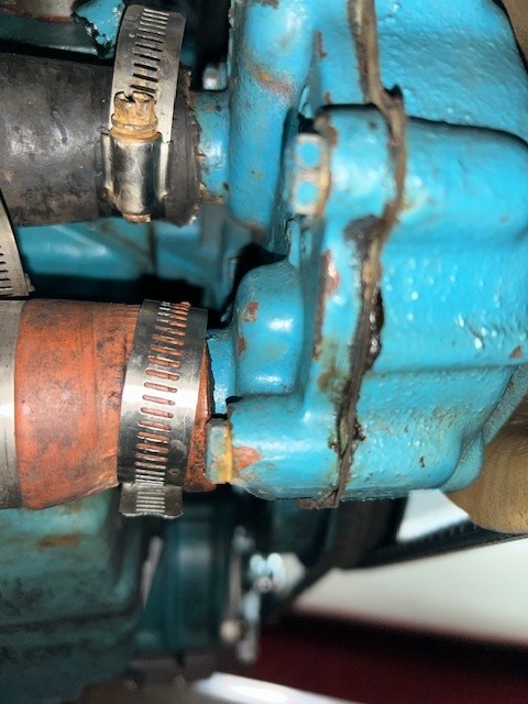

I have what appears to be a hard to find sea pump. It is spraying water around the belt shaft. Any help locating parts or other matching bearinds or seals would be great.
possible SN D 315751
1975 225 Mustang 17' 307 Chevy OMC

they aren't real common...I'd say most likely an old sherwood pump.

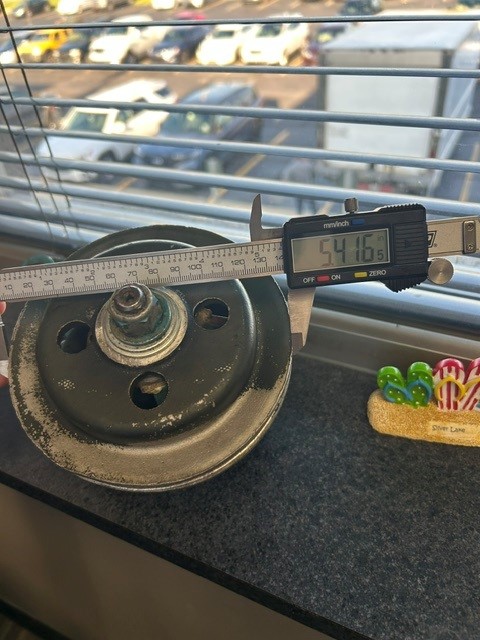

What's the OD on the V-belt pulley?

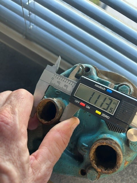

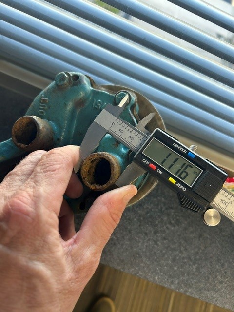

Can you measure the hose sizes - I'm thinking one is 1" and the other is 1.25" (measuring the hose nipples on the pump, below the barb, is probably the most accurate)??
Makomark, thank you for the reply. I assume since you are asking me these questions you have an idea about some kind of retro fit part?
In any case pictures are included with callipered dimensions in inches. again thank you!

Yes, had a hunch but it didn't pan out...an old Sherwood G9902.
Usually, you can find the identifying numbers/marks/letters via close inspection of the pump. Like alternators, they are usually bought from one of the specialty suppliers as turn key subassemblies. If you can't find that data, a place like Depco Pump Company will find you a replacement or offer ideas. Worst case, you could use a crank mounted pump, something similar to a Johnson F5..
