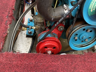

Ayuh,..... Take it off, 'n look for a number or name on it,...... I believe the ole stringer drives had the pump in the drive,....This must be a very rare pump. Any suggestions on replacement? Very little room in front of crankshaft for a pump there. This has a belt driven pump located right in front of the fuel pump on the Chevy small block.
Workin' on boat motors, many times you have to remove enough "Boat" to get at the part ya wanta fix,....

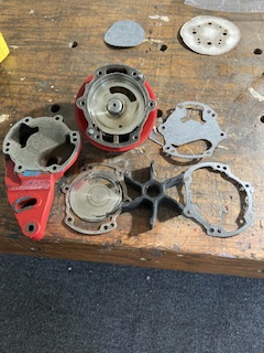

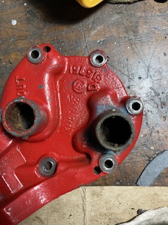

Here are some pictures that is the only thing I can see on pump. I am told it’s an original OMC and no parts are available for it. So I made the gaskets, cleaned it up, new, bearing and seal and put it back together. Something must be wrong with it.
