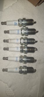

Those are the brand new spark plugs

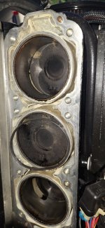

Found this under the cowl, any idea what this is?

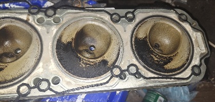

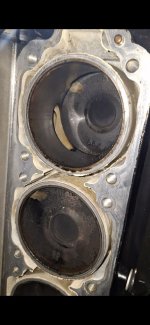

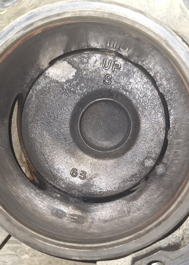

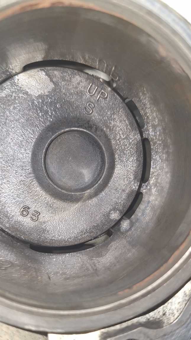

Opened up

No, everything looks fine under the cylinder head i think...someone told me the problem might be the reeds. I did look in the exhaust manifold and its caked up in carbon.
