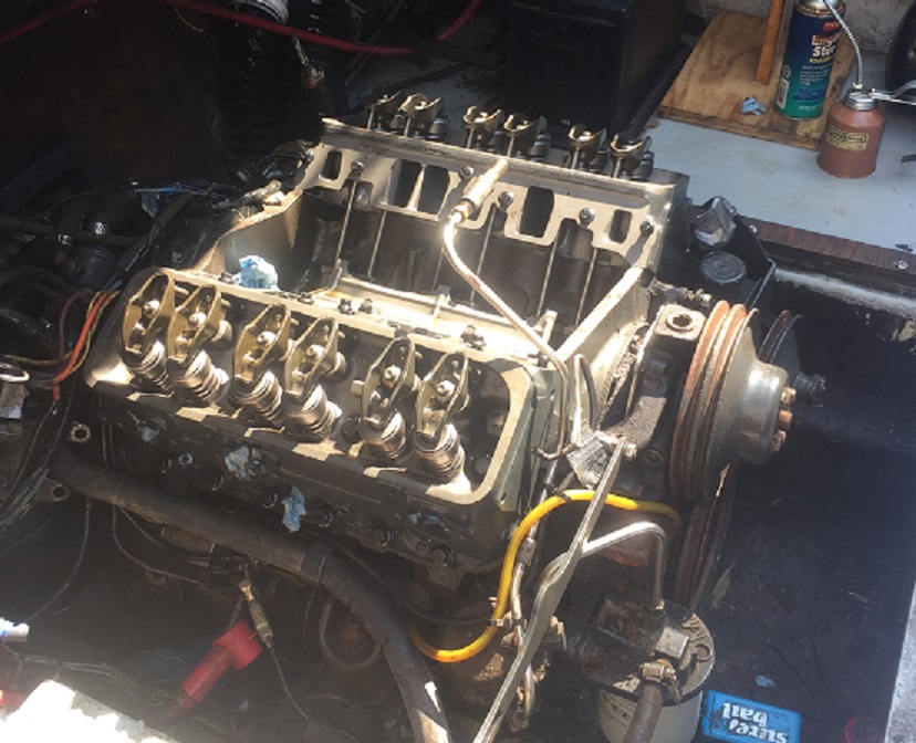

If it is the exhaust valves, as I said the exhaust manifolds can be removed to inspect/assess. If the intakes is the problem, the EFI intake manifold would have to come off to get a better look at them. If there are problems in either area, the usual way of repairing it is to simply take the cylinder heads to an automotive machine shop, they will check the heads for cracks, and perform a valve job, like they have done on probably thousands of small block Chevrolet cylinder heads, and re-assemble the engine with new gaskets, exhaust, etc. It's actually not a hard job, I did the same job on my '88 Chevy/OMC 4.3 V6 about 8 years ago.
