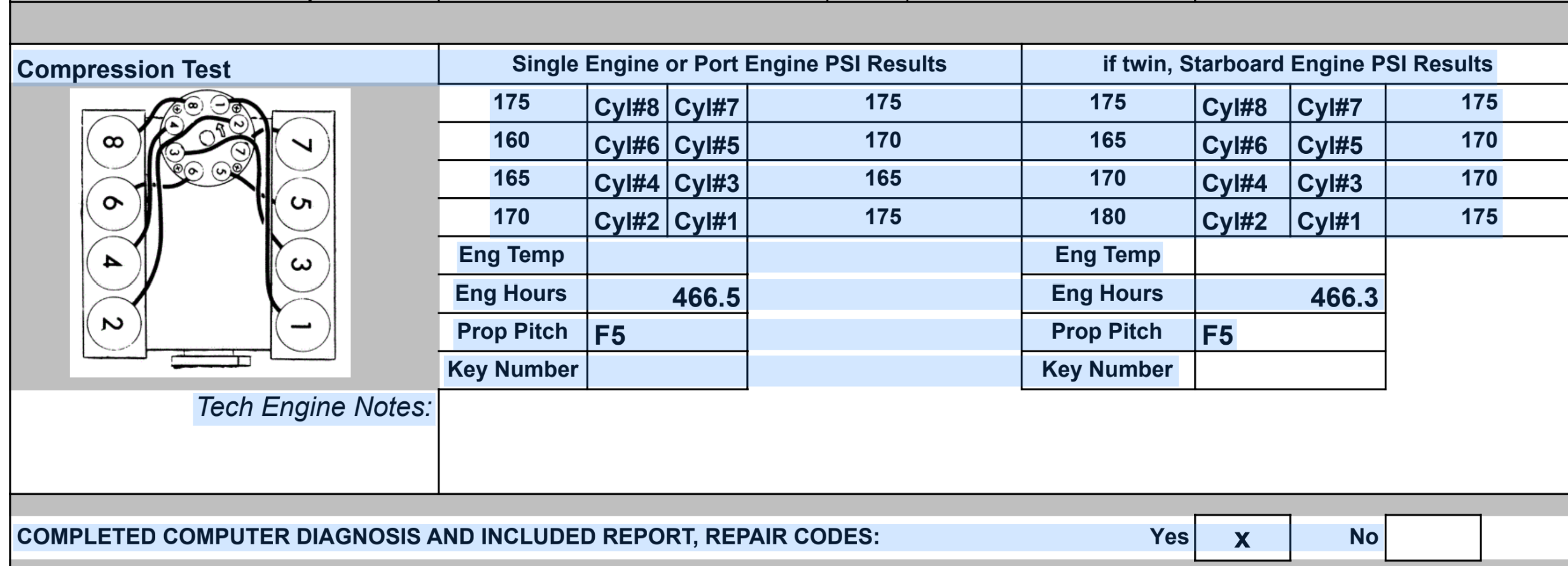

Hi, I put in a great offer on a 2006 Cruiser with Twin Volvo Penta 5.0V8 GX i engines. I had a proper compression test done and attached are the results. I was kind of shocked surprised with 466 hours at the results. I know is well possible but don't see this much from a 2006 engines at all.
I know that the rule is 10% - 15% across the board of each cylinder within. I researched that this Penta GX i normal compression range is between 125 and 175 PSI. Calculating the average of all 8 cylinders I came up with 170psi on all 8. The test was done a few times for accuracy and this was actually the medium of high and low. The results were always +/- 1-3 psi variable.
The Engines both have 466 hours on them backed up by the ECM hook up readings and hours digital gauges. The info I have on the 1 owner from new previously is that they changed the oil & filter every 40 hours. It's a Freshwater only boat also, and is in very good condition for the age. I was a bit concerned about the 4 lowest cylinders on Port - # 6, 4 & 3, and Starboard - # 6. A long time Tech told me those were well taken care of engine numbers, and he would take those any day.

The engines are in decent shape...based on the compression data...
I wouldn't take it apart until it needs it...when it comes time for the valve job, I would worry about the valve job ( 3 angles are plenty) and wouldn't worry much about porting ...get rid of the flashing and leave it alone...what works in a race car usually doesn't work in a boat engine...

On your compression numbers, for reference, GM redefined what was acceptable for a compression test and they did it back in the late 1990's. cold engine; no cylinder below 100 PSI and no cylinder below 70% of the max cylinder observed...much less stringent than the traditional 10% limits...
