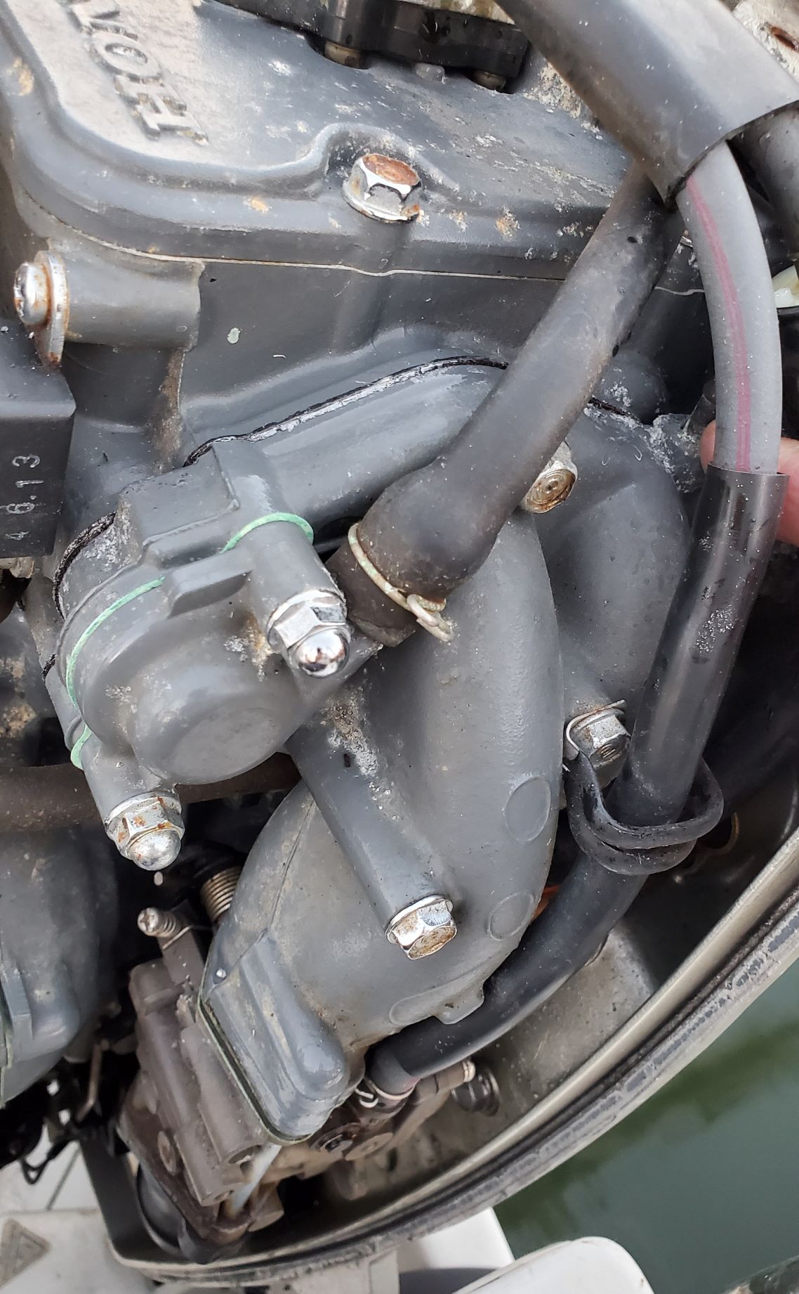

Here is a photo of my engine. My finger is on the small nozzle off the manifold that the tell tale hose attaches to. From the diagrams you shared, it appears that the water bypass tube is the hose to the left of my finger coming off the thermostat. What exactly does this hose do, and how does that relate to the tell tale?

That hose delivers water to the intake manifold as well as exhaust manifold for when the thermostat is closed and won't allow water to exit the cylinder head. It is fed from a "T" passage at the base of the engine block where coolant enters the engine from the water tube feed from the pump.
BUT...
If that hose gets substantially plugged, it will still interfere with flow through the tell tale even if the tstat is open because it will create a sort of "lock" condition that resists flow through the system. Kind of like putting your finger over a straw and then picking up any liquid in the straw.
Probably not the best example I could offer but suffice it to say that the hose and that "circuit" needs to be unobstructed and free flowing at all times for the water check (tell tale) system AND the cooling system to perform properly.
Good luck.

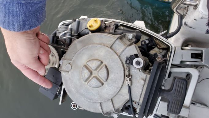

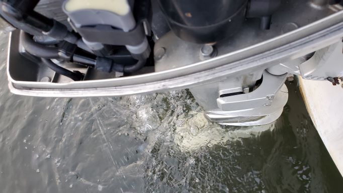

Thank you for the detailed response....and now the plot thickens... Yesterday, I started up the engine before checking for any clogs. The tell tale was spraying water, not a full stream, but more part of a mist. (photo attached). But at the same time, the engine was running rough seeming on one cylinder. This happened when my engine was at the dealer and they diagnosed and replace a bad coil. So I had a partial tell tale stream, but the engine kept bucking harshly. I reached across the top of the engine to put my finger over the tell tale hole to feel how much pressure was coming out of the hole. All of a sudden, the engine was firing on both cylinders. Apparently, I accidently touched a black box on top of the engine and the engine started to run properly. I shut off the engine and restarted to duplicate the fix. It ran on one cylinder until I touched the bracket shown in the 2nd photo. I researched this box and appears to be the Ignition Control Module. Is fixing this ignition issue as simple as cleaning the contacts on the bottom? Or will I need a new unit? Back to the tell tale issue... While I was able to duplicate the "fix" of the electricial issue, the tell tale was still spraying, not streaming water as seen in this video: https://drive.google.com/file/d/15qtOVYqrBA67k45CCfucslI84zZFgD7-/view?usp=sharing I shut off the enging and restarted, and the tell tale streamed properly as seen here: https://drive.google.com/file/d/15TNahIS2-fuZxqrp8zpdT5kUnQVbJZDA/view?usp=sharing

Hey number 6,
Well, from where I sit, all I can do is guess at the answers so here goes:
As far as the ignition control module, I don't think you have any choice but, at first, to try unplugging it and seeing if you can clean the pins and connector sockets as best as you can. You will want to remove any corrosion you find but you need to be careful not to bend any pins or enlarge any sockets. Use a good contact cleaner like DeOxit. You might need to gently scrape at any build up with something small and sharp like a pick with a bent end or even the end of a paperclip shaped to do the job.
It's important that you make sure all the pins have a "drag fit" in the sockets. Sometimes a VERY MINOR twist of a pin with a small needle nose plier can improve the way sockets and pins fit together but be very careful doing that. If cleaning the connections doesn't work, you may need to replace the ICM. Not cheap!
As far as what I see in the videos it appears to me that there is some obstruction in the tell tale circuit. Just my opinion but I think it should be flowing better than what I'm seeing in the second or "after" video.
But, it IS flowing and that's good. If you can get the engine to run correctly and it doesn't overheat then you might be able to operate it ok as is. You will just have to use your own judgment as to how aggressive you might want to get trying to clean the tell tale circuit and improve the flow.
Again, caution needs to be observed. This outboard is old and I guarantee you that there are scale deposits in the intake manifold water passage and in the bypass hose. But I know from experience that trying to do too much with these old girls will often create more trouble than it's worth. Those deposits embed into the metal and trying to dig them out can end badly. If you damage or break a part that's no longer available then you can't use the outboard at all.
Sometimes leaving well enough alone is the best thing to do.
Good luck.
Another possibility that comes to mind about the ICM and how touching the mount seems to change the way the engine runs is the wiring.
These engines vibrate quite a bit and over many years of running the wiring might get "stressed" by the movement. I have seen multi-strand wires broken right at the crimp where they attach to the connector.
Just something else to keep in mind as you try to figure this out.
