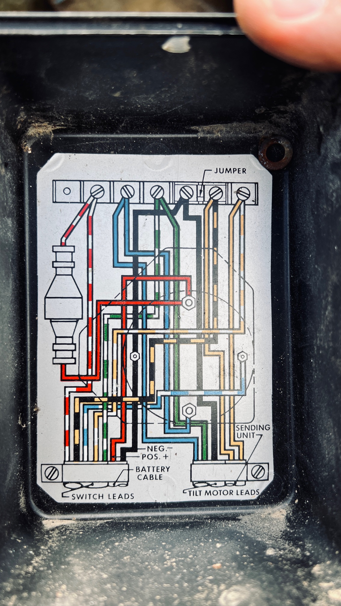

There is a solenoid for starting the outboard motor.----There is a separate box with a solenoid for the trim tilt.---Should be in a box inside the transom.----That is if it has the original 77 set-up.----Picture / description of your system is needed.
Yeah, that is the setup. I'll try the blue to +, black to - method tonite.

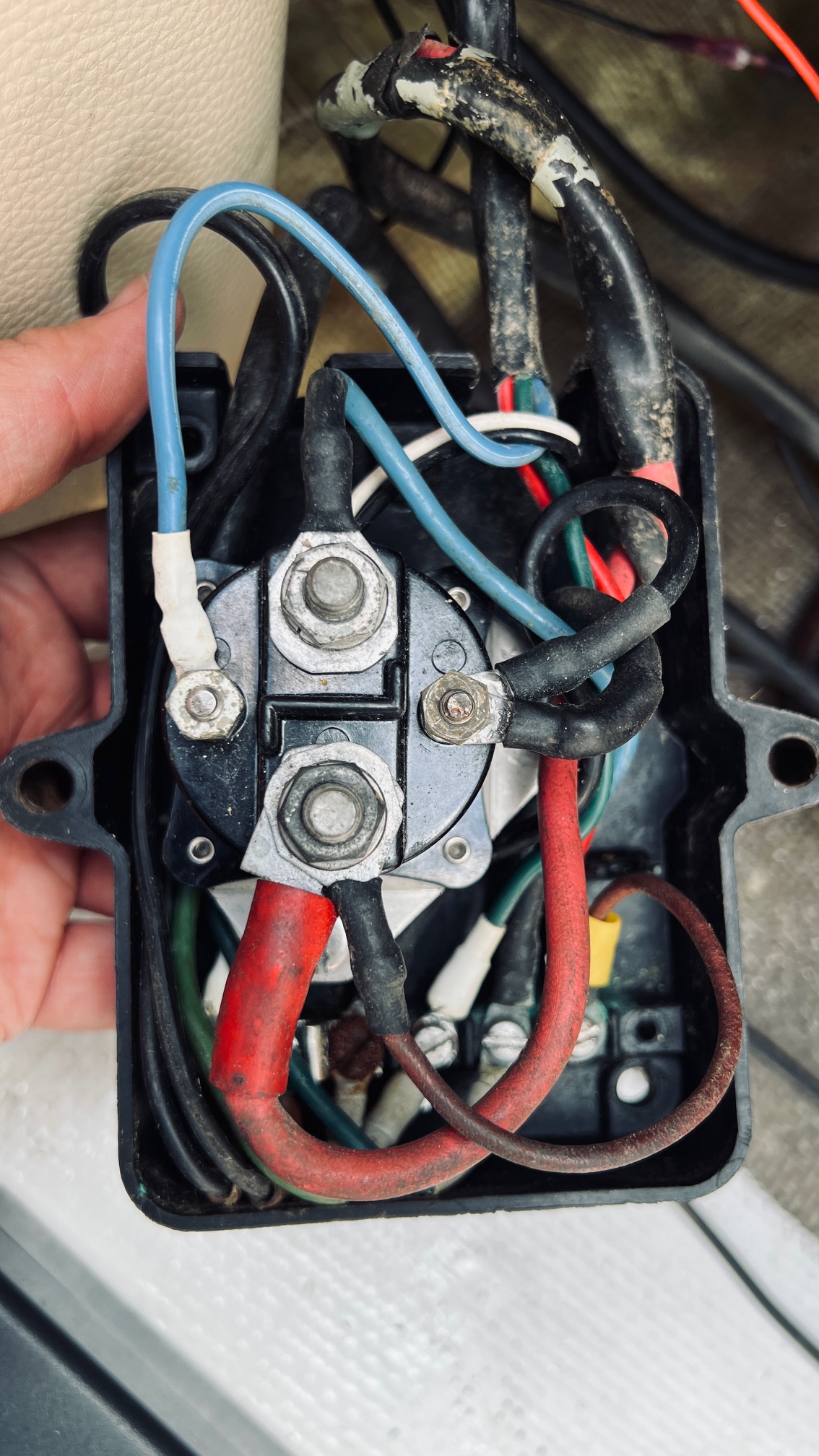

so, quick update:
Went directly to the battery between the outboard and solenoid. Worked for up and down. (Blue and green)
Went directly to the battery between solenoid and switch, only down (green) worked. Blue/Up didn’t to anything.
So I guess the solenoid is the problem, right?
Filled up the tilt/trim fluid also, just to be sure that it wasn’t that.
And another update: could wait, so I tried the new solenoid this evening. Nothing. Green (between solenoid and switch) works, when directly connected to the battery. Blue does nothing between solenoid and switch.
Maybe a wiring issue on the solenoid or the new solenoid is also messed up.
Can I somehow feat the solenoid?
Bought another solenoid - finally it works and goes up and down.

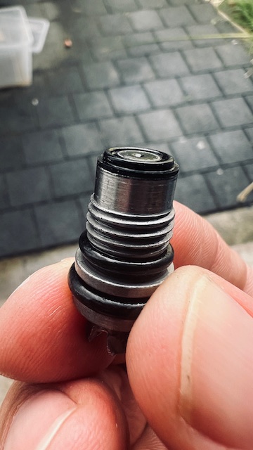

Now the next problem: because the seal of the screw to manually lift the trim (that one on the side of the tilt/trim unit) is broken, the fluid is dripping out the whole time. I probably unscrewed it once to often.
I can’t get the screw out - it only turns a few times… I’ve seen that it has some kind of ring around it.
Any idea on how to get a new seal/gasket behind that screw?
Outward pressure while turning to loosen. Then tap threads to next size that will work. Vacuum out any filings. Provide correct bolt/screw in stainless or brass with proper fitting washer to seal. All parts likely available at you local hardware store.
got the relief screw out and a new seal in. Relief screw now is not leaking anymore.

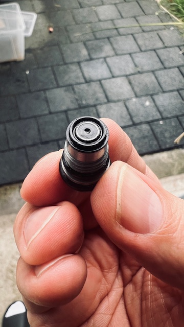

I think that I am getting no seal-off for the power trim. At least it seems like it.
What I did: I closed the manual release valve (which I fitted with first one, the two seals - no idea, if that is right, can’t find a foto of that screw with a seal at all), then I pump in some fluid (which I have now done several times, even tilting the boat slightly with the trailer, so that more stays in). Nothing comes out of the release valve, this is completely dry. Still I can move the motor up by hand. Also it still “falls” down, when I let go of it.

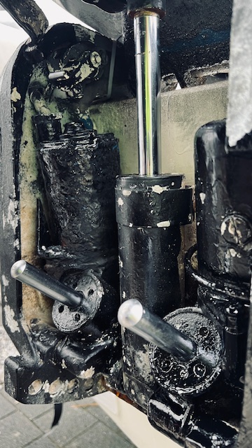

Lastly the two pistons that hold it in the end (at the bottom of the unit, no idea what to call them) don’t go back in but stay out, even if I try to trim the motor.
This is really frustrating right now. I have no clue what could be wrong.
Maybe someone has an idea.
Post a picture of the 2 pistons / cylinders that you speak of.-----There may be issues with check valves in the hydraulic valve body.
Here a photo of the pistons - yes I know they look messed up… but they worked a few days ago.
And two photos of the relief valve. I put on a seal at the top, the second one I took off again, as I thought that the screw won’t go in deep enough.

Yeah, and funnily enough the went all the way in a few days ago without a problem.
I will try to get more power trim fluid in the cylinders over the next days. Maybe that helps.
Does the fluid spread through the cylinders if I lower and raise the motor manually?
