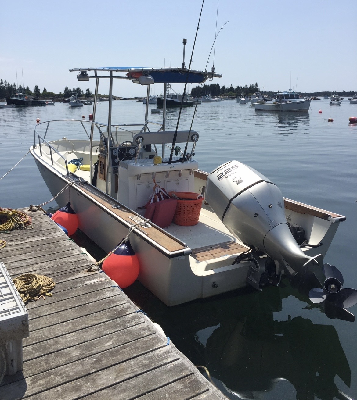

I’ve been running a 15.5x17 Solas 3 blade, it’s been adequate but I top out around 5400, am I over propped? Rarely run wide open, cruise at 3500 to 4000rpm.
Pic for attention

Does that little chunk that's missing cause much vibration? Is that maybe why you're considering the replacement or is it the missing 100+ or so rpm....or both?

jgmo,
That's a photo from a couple of years ago, I did change that prop out, and yes, I could feel some vibration. We have a lot of driftwood floating around up here after a big tide, my luck ran out, missed seeing a pretty good sized chunk.
