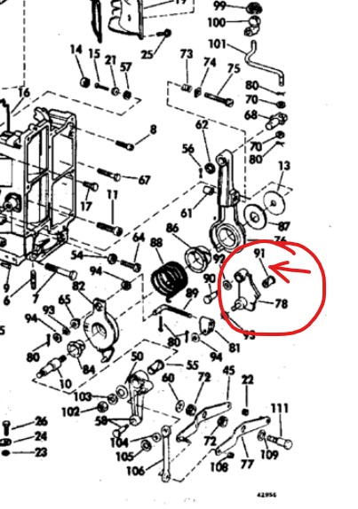

Make sure the Throttle Cam Bushing Part# 0314137 is there. It's #91 on the Cylinder and Crankcase parts diagram. If that bushing is missing the throttle cam will not engage the linkage to advance the timer base at the right moment and can cause bogging issues when accelerating.
Thanks, I actually remember that part from a 8hp Johnson where it was missing.
But I did finally find the issue with my 135hp Rude. It was just a sticking timer base. Back to rippin'(y)
