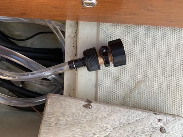

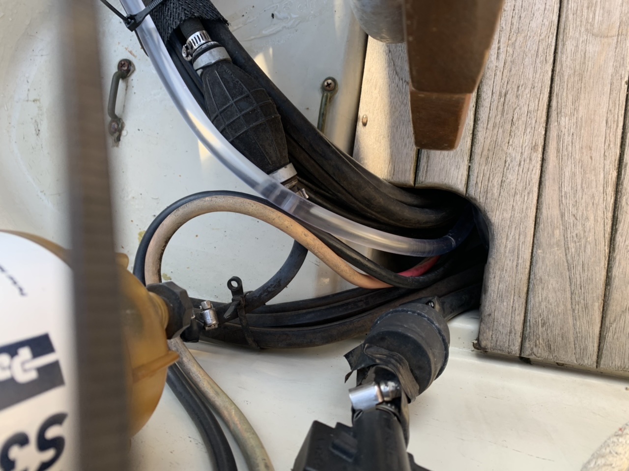

Thanks for the replies guys. Here’s what I ended up doing: popped off the female end, connected a 10’ 3/8” ID hose on the engine side (left the male fitting on its own), then put the female end back on the end of the new hose, which attaches to a brass fitting that has a shutoff valve and female end to easily connect to a hose or the salt-away device. This is super easy, no hanging half way off the boat to get the hose on and off!

The end is tucked under the small hatch when not being used.

Coming back to this a few months later - this has been a great upgrade making the flushing process so much easier. Good luck to others who try it too. Only recommendation is to keep the pressure fairly low, no need to go nuts!
