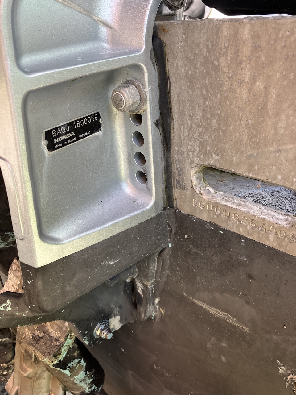

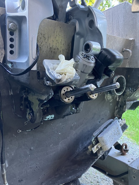

Trying to get tilt trim assembly out of the bracket as seems easier to service on the bench (loosened caps while on bracket) but want to take the pump off and change the mount orings.
The lower pin is removed but it seems held in there by some internal washers. Manual suggests the brackets would have to be removed which would mean hoisting the engine.
It won’t tilt down due to motor - so I removed that and now it’s binding on the pump housing. I think I have access to remove it from here but it seems more of a PITA than it should be and wondering if I’m missing something simple.
