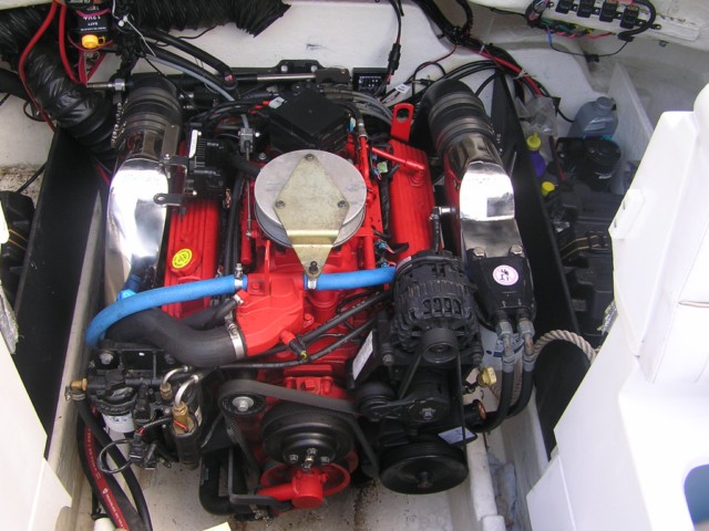

Well today I went out and bought myself a length of 41/4" plastic drain pipe which I cut into a length of 26" as a template for the HE
This is where I got my first surprise the front removable bulkhead of the engine bay is far too close to fit a HE tube af any dia.
but in a Monterey there is acres of room either side of the engine. Most of it wasted space I reckon. A 6" X 30" HE would easily fit lengthways to the engine so this is where I will place it. It will mean that some of the connecting hoses will be longer than normal but I don't think this will be a problem.

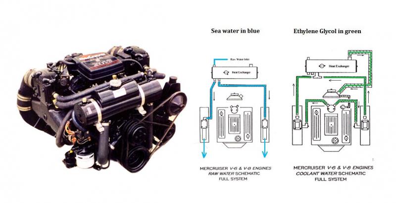

We will occasionally see a remotely mounted (off-engine) H/E. However, if you were to do this, I would give this some careful thought before purchasing the H/E .... in terms of the port configuration.
It can be done!
yes I had thought of the porting locations, there will be more than enough room under the HE so I was intending to double clamp all those hoses that come out from under the HE and then cut them to length when it is in position./

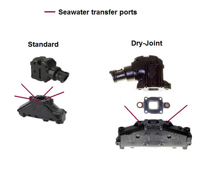

Just a thought:
If in a Half Closed Cooling system scenario, the dry joint is of value.
However, since the Full Closed Cooling system separates the manifold from the elbow, the dry joint concept is of no real value.
But in the long run I recon that the Merc 'dry joint' type of manifold is far superior to the Volvo (or old Merc types) in that water cannot leak into the engine as the water connection between the two joints is outside the exhaust passage way.
As you know, the exhaust gas passage and the seawater transfer ports are separated greater with the dry-joint system.... in other words, there is more material between the two areas.
(See image below)
This is the system I would prefer based on all the excellent and informed advice I have received here. But I cannot establish that a Merc set of Manifolds elbows definitely fit the Volvo 5Lt engine. Capt Bob seems to be sure that the Merc mainfolds will fit the Volvo. I guess they should as the blocks are the same. Connecting up the 'Y' pipe seems to be the biggest problem fo me as there is no 'open sky' access to the rear of the engine.
Minus any mounting bosses for electronics.... they will fit the SBC engine!
The issue will be the elbow down angle, and whether or not the elbow alignment to the Y-pipe can be accomplished easily.
If I go along this route will I need a new Thermostat housing for FWC and will it fit the Volvo??
You will need to change this housing whether you go with a Half or Full system.
The image is a picture of a Volvo 5Lt V8 fitted with SS integrated exhaust/risers.
The two blue pipes in the image are the pipes that I am talking about. in this image they go to the two inlets to the SS manifolds.
On my current engine they go to the CI exhaust manifolds.
When I fit the HE I intend to connect these pipes together via a "T" pipe and feed the water back to the HE.
In the Volvo closed cooling system these outlet pipes from the thermostat housing do not exist.
I saw an image of the "T" pipe somewhere in an arctical on cooling , I believe it related to a Mercruiser but the water ciruit must surely be much the same for both makes.
You're talking abut two the blue hoses, not pipes.... correct?
Yes! This is the "spent" seawater path.
Whether the engine is raw water cooled or a Half CCS is installed, this path would be the same.
Unless you're doing a Full System, this is "spent" seawater, and will enter and exit the exhaust system.
IOW, there is no returning water or coolant to the system from this location.
Be careful when you "T" or Split water flow.
Depending on which part of the system, this will require a "diverter style T or Y" ...... not a normal T fitting.
Correct! The Raw Water cooled engine thermostat housing incorporates a mixing chamber.
This style cannot be used for a Closed Cooling System.
(see image below)
You'll find that there are similarities.
Does your kit not include all parts?
Blue represents seawater.
Yellow represents mixed tempered water heading for the engine's Circulating pump.
Red represents water that has removed engine heat and then becomes mixed with incoming seawater headed for the exhaust system.
The closed cooling drawing is an example only.
