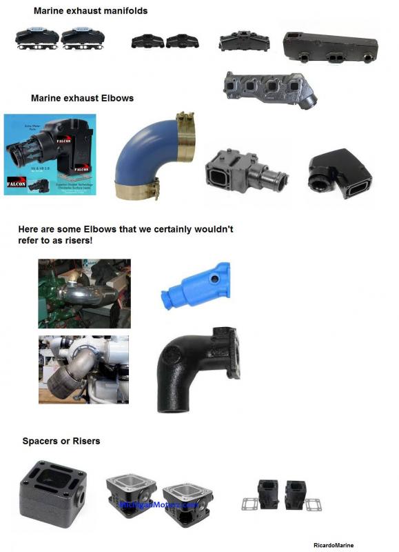

Sorry..... try this one.

Note auxiliary water passages ("C" passages) bypassing the exhaust path flange at bottom i.e dry joint
Dry Joint Elbow.jpgOn a dry joint elbow, the water passages are external and not cast as slot passages beside the exhaust flow.
These are dry joints, check out the one on the left.....even though the dry joint design is definitely better than the wet joint as you can see in this pic this engine could still have had water ingestion due to the rotted area you see on the left one. So like I said, unless you take em off and check you will never know until its too late. My engine originally had OMC one piece batwings and I replaced those every 5-6 seasons, by the 6th season they had corroded enough that one of the elbow water exits was getting clogged. Never had water in the engine on that schedule of replacement and they were not cheap...approx. $450 a piece. I changed to the Barr 2 piece style used on later OMCs and Volvos since the batwings had long ago become NLA. I had to buy some V/P exhaust pipes & hoses that fit between the elbow and the Y pipe, with these it all fit like factory. The cost of the manifold/elbow kit with the gaskets and bolts is approx. $720 or so. But expect the Merc dry joint to cost more....I do think it is a better design...I would have adapted it to my engine but the angle of the elbow is different from OMC/Volvo to Merc so I was not sure it would line up.
