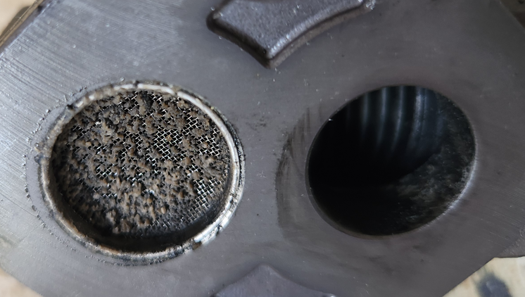

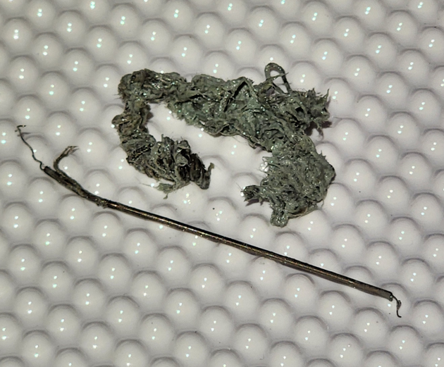

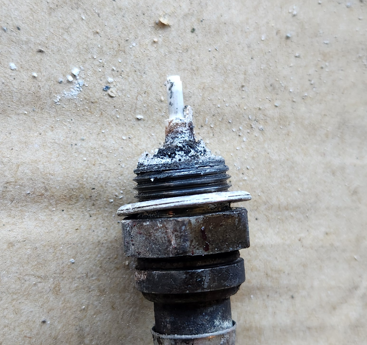

Thanks. I have cleaned the screen on the IAC valve and the fire screen in the air intake box. The issue must be engine temperature related. I can rev up the engine and let it idle at high RPM (> 1500) for a while. Then the engine won't "stall" after that. I will hook up my diagnostic tool with the engine running next time to see if there is anything out of ordinary.

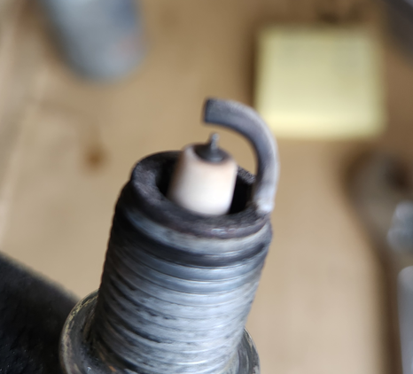

Have you checked valve clearance, they are very critical to achieve a smooth idle. As Janz said too, O2 sensor can be getting old. doesn't always log a fault code. There's nothing to beat getting proper diagnostics, there more to diagnosing an issue than pulling codes. You also need a good understanding of sensor values, you can have a sensor sending an incorrect value without logging a fault. You've done very well so far.
Thank you for the reply. I will take a look at the O2 sensor values while the engine is running. A valve adjustment job is planned for this winter. So far I am happy with the engine. It is a 2008 engine with 1050 hours on it. I had it for 9 years and it has been good to me.

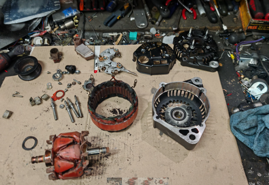

- When engine idle at low RPM <1000, battery light will come on and alarm goes off. Once RPM goes above 1000 RPM, alarm goes away. Suspect weak alternator. Will check and replace/fix alternator at end of season if necessary.

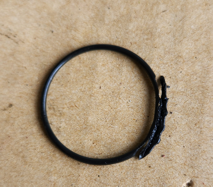

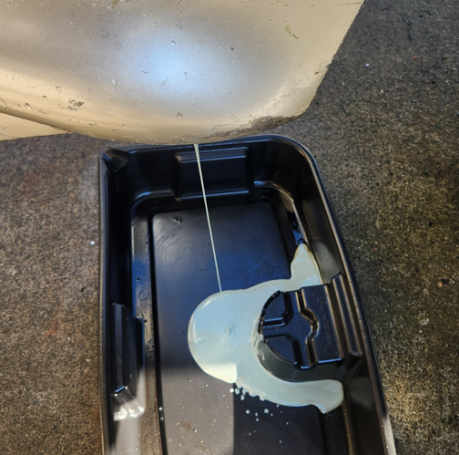

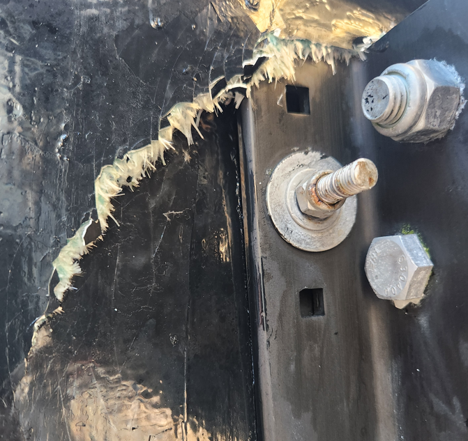

- There is a very small gas leak. Strong gas smell from time to time and show a film of gas on water. Need to check all gas connections and tighten gas filters.
Going to enjoy the season and try to fix issues at the end of season. A boat will never run at 100%. There is always an issue here and there.
A fuel leak can allow air into the fuel system, that will cause lots of running issues at idle and all the way through the rpm range. Plus gas fumes are very volatile, you might blow up. Could it be a fuel tank leak- pressure test it. You only need to apply say 2 lbs of air pressure.
