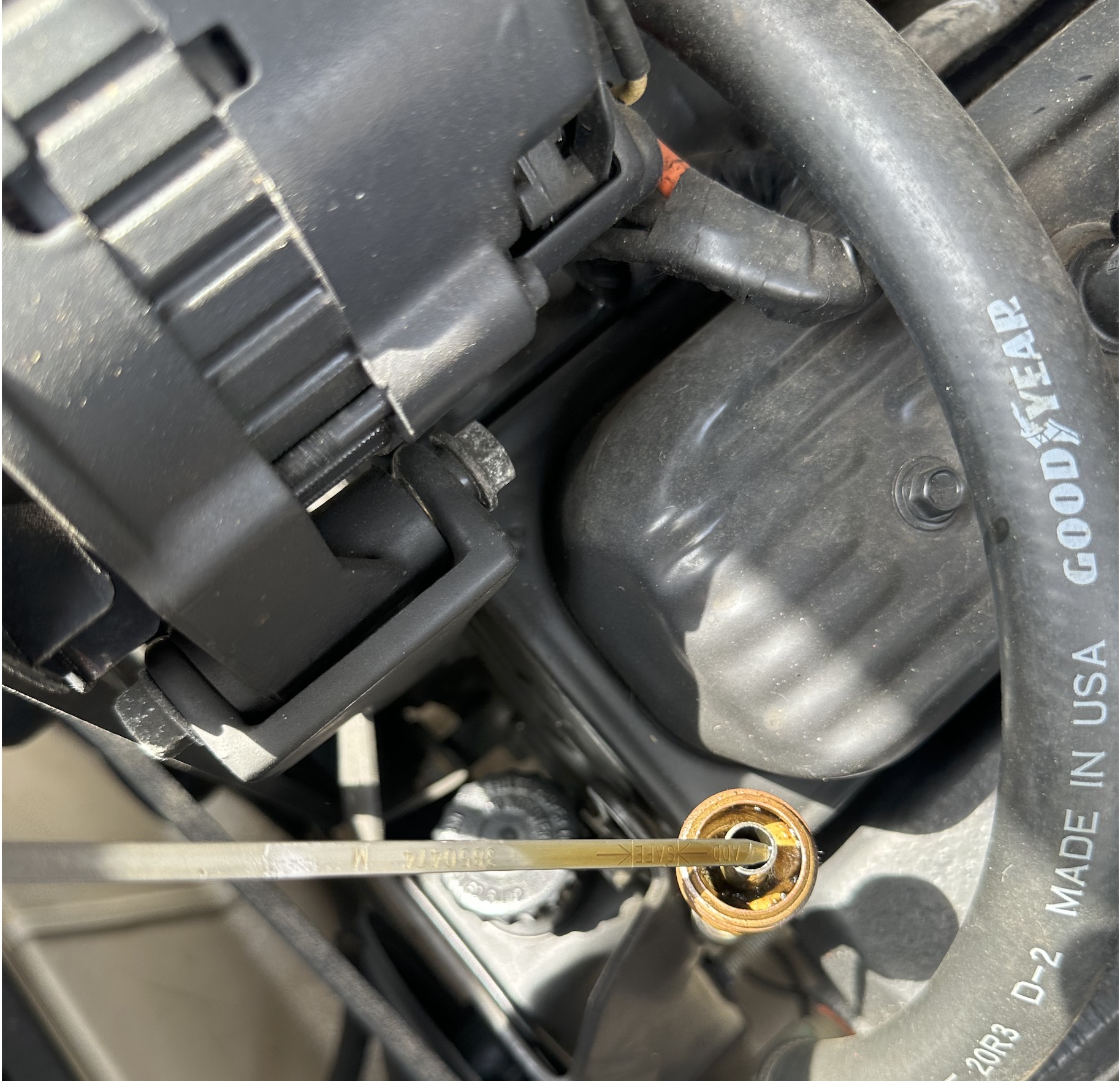

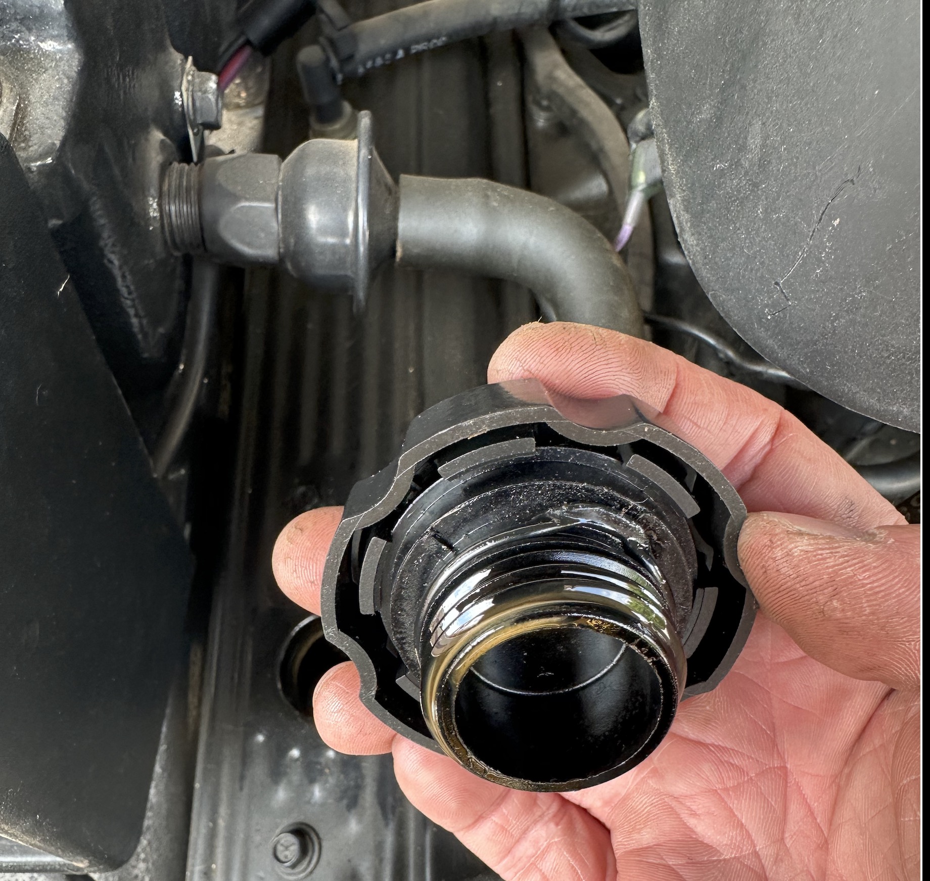

Today I sucked the oil out from the engine, first couple of pumps were water then changed to oil. I removed the oil filter from the block, had a mixture of water and oil in the filter also.
Filled it with some cheap 15W-40 heavy duty diesel oil, put a new filter on. Sprayed some fogging oil into the spark plugs holes.

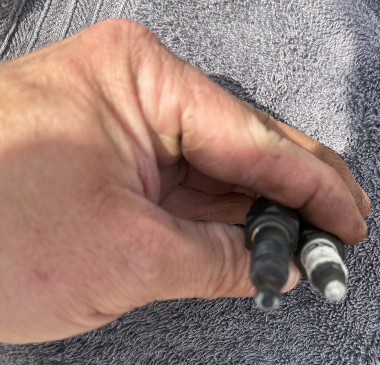

Put all new ac-delco plugs in the engine with the proper gap.
Before reinstalling the plug wires I cranked the engine over with the starter.
Then I plugged the plug wires into the spark plugs.

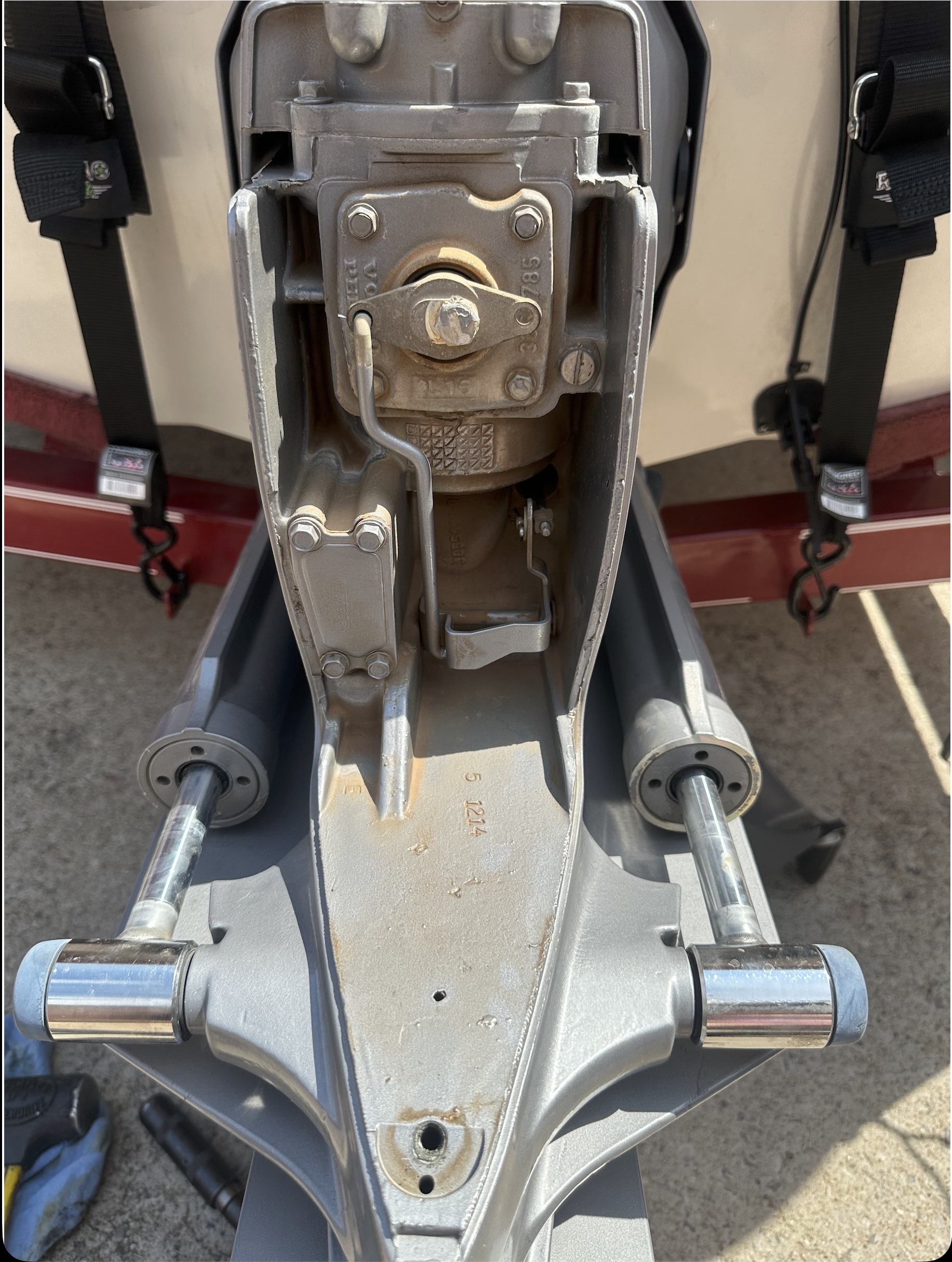

U-joint bellows are inspected visually from the back of the boat or better yet, pull the drive after the boat has been in the lake. Running on the hose won't tell you anything about the bellows.
Each season the drive should be pulled at the end and all of that inspected (bellows, gimble, u-joints, input shaft seal).
I also tilt the drive up and look in the folds of the bellows, if you see small cracks forming it is time to change them because that means the rubber is getting stiff. I have found the ones for my OMC Cobra last at least 10 years before you see cracks forming and this is with OEM parts.

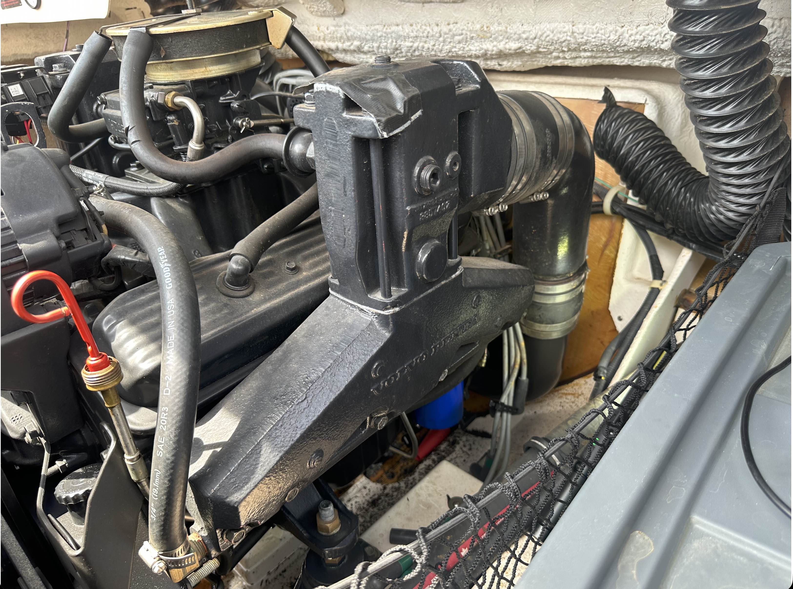

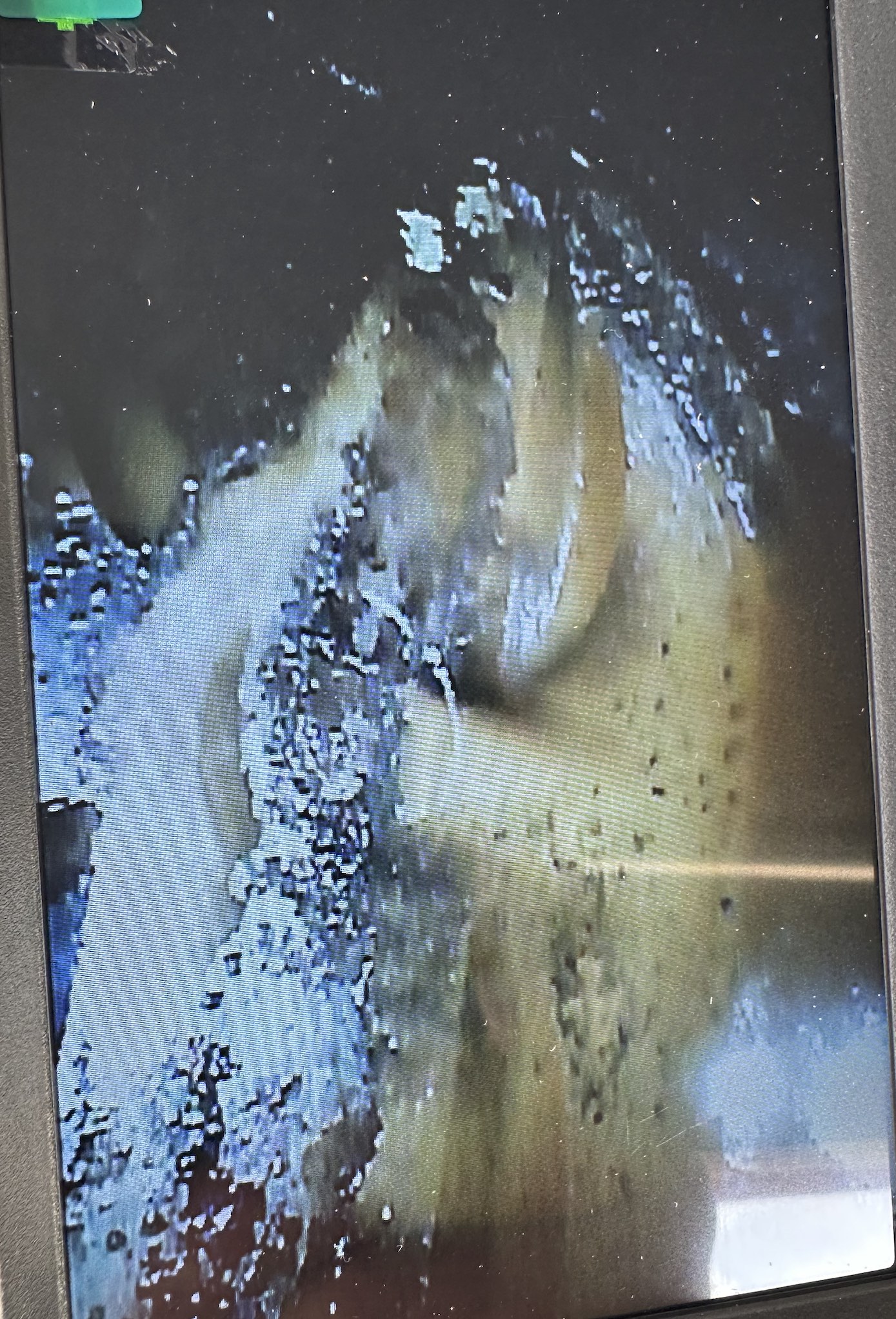

So, the question is now, how did water get ingested into the engine?
I don't see any cracks or rust marks on the exhaust manifolds. I don't see any cracks on the elbows or rubber that connects the manifold to the elbows.
Currently, I am waiting on the 75W-90 Volvo Penta gear oil for the drive to be delivered so I can drain the old fluid out and put new in. If the bellows are leaking/bad, would that allow water to be ingested into the engine?
If there is a seal or ring that is leaking water into the drive unit, could that be ingested into the engine somehow?
Im struggling to figure out how water got ingested in the engine. Something doesn't add up from what the "mechanics" said about the engine being seized and them not able to turn it over and it needing a new engine.
