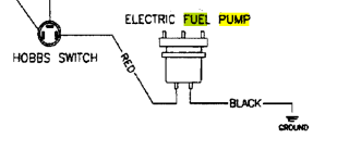

The pumps run for 2 seconds then stop. I'll try to jump it and see if I can pressurize the system.
Is there any convenient way to know if and when fuel has flowed through it? Or just run it for say 2 minutes and then see if the engine starts?
fuel flowing...good question... I would say one minute is enough to fill the system...you may be able to hear a change in the pump's speed as the pressure builds...the TBI's usually don't need more than 20 PSI to work so its not always easy to hear the pump change...
