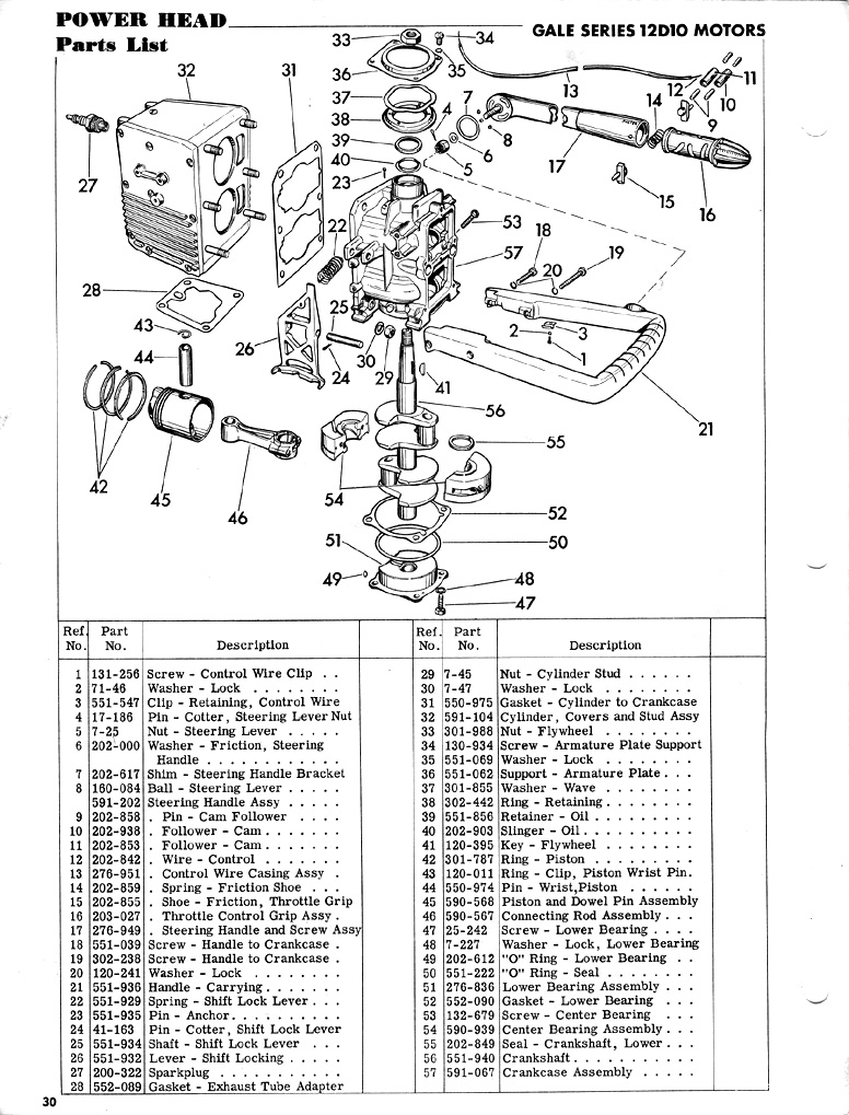

Here's the 12hp Gale version. Similar to the Evinrude 14hp but with some differences

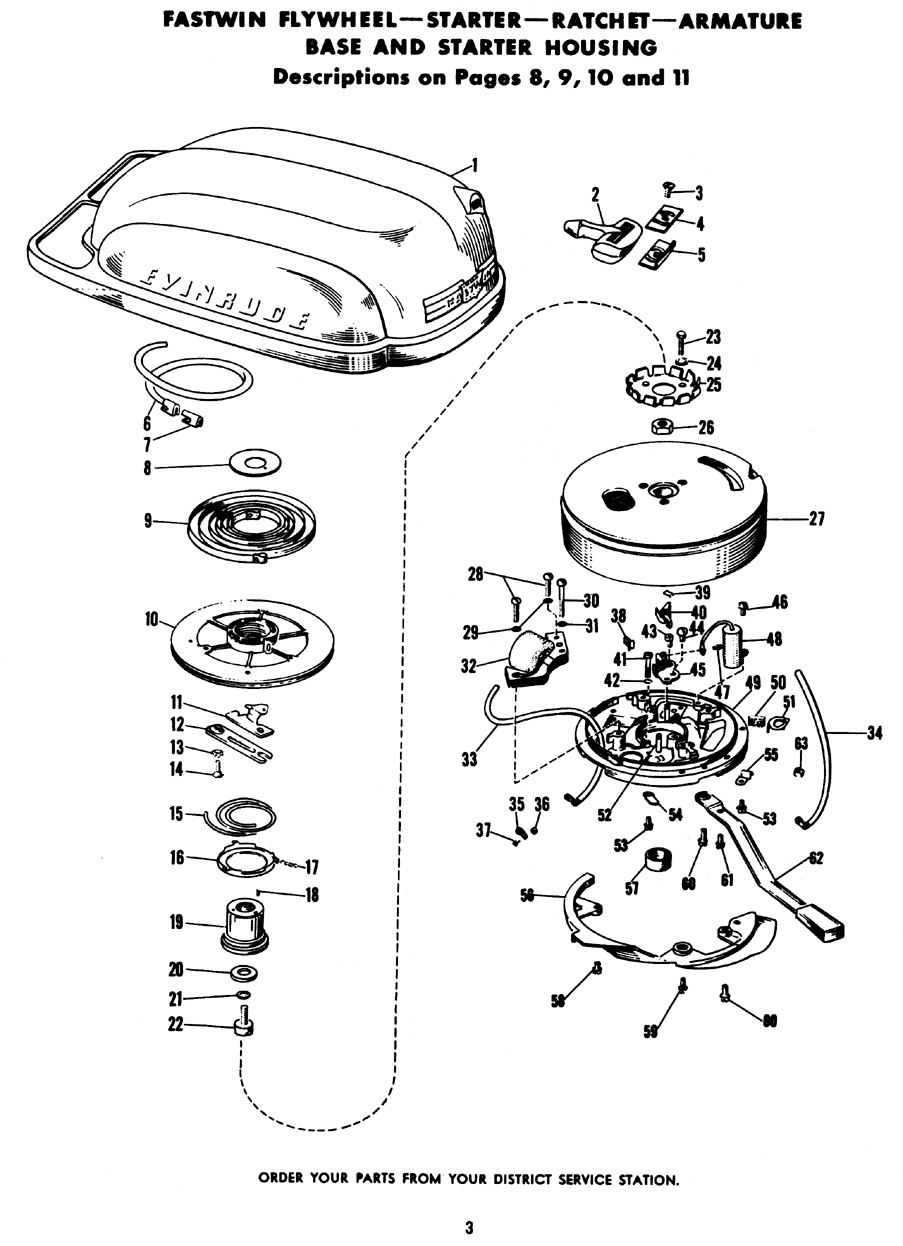

I lost my data in a computer crash. Here's what I have left
