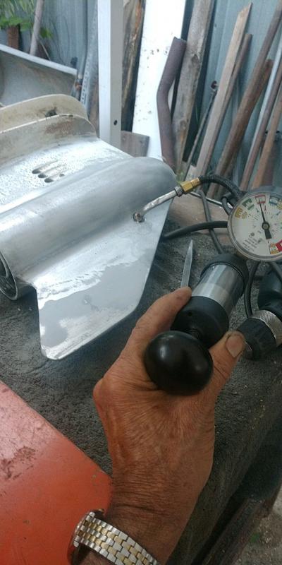

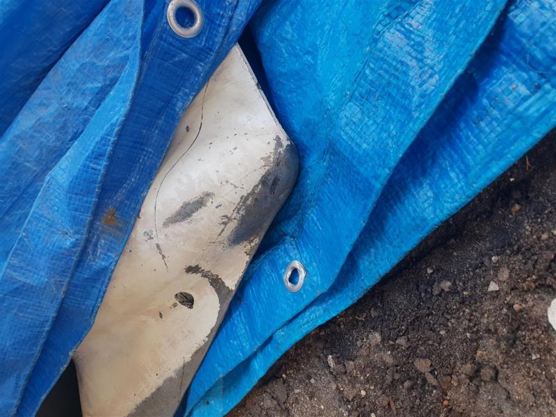

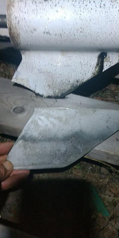

Excellent, enjoyed the reading, lots of good information there as well. I do a fair amount of prop and skeg repair, often welding cracks too. May shops will use annealed aluminum for skegs, bad idea. I keep cast alum with cast alum and use skegs off of parts motors. Use a couple of different filling alloys, sometimes welding complete blades on useable prop hubs.

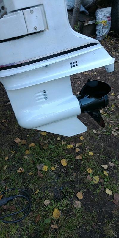

Here is a recent job on a Johnson 75. Did prop repair too. Basecoat acrylic enamel and topcoat epoxy clear. Beyond factory specs.

Talk to a good welder, they'll tell you it's 50 percent welding and 50 percent "artwork". Nice paint helps the owners "feel comfortable" that what's underneath is gonna work well too. It's not putting a bowtie on a pig, it's more like putting a bowtie on a Playboy bunny. What really counts? The bowtie, or what's underneath it?
