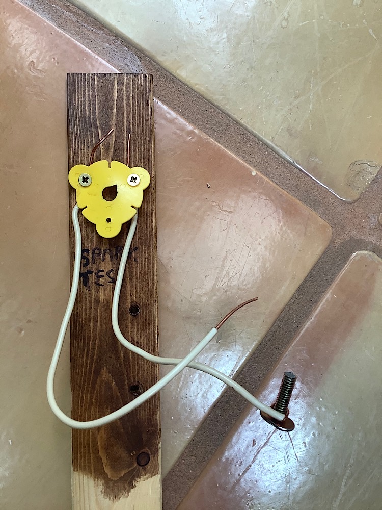

Make, or buy, (about $10), a spark tester out of a few scraps, like this. You can use any method to hold the wires, hot glue gun, a short bit of wood or metal with a screw through it etc.
Plug one wire into the sparkplug boot,ground the other to the motor block. Space the wire ends at 3/8”, don’t worry about being exact, it should jump the gap with a hot blue/white spark.
