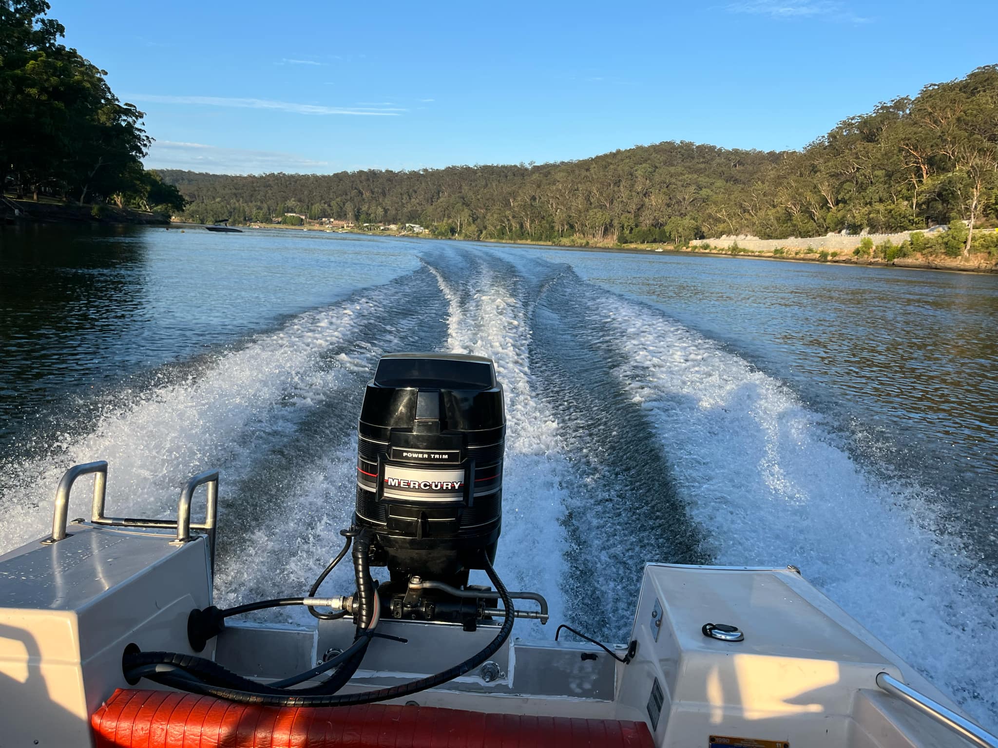

Nice clean rig. Looking at your wake its moving right along.
It gets along ok, top speed is about 35 knots. I was taking for a test run after lifting the engine 2". I was probably doing around 24knots in that pic, my usual 4200-4500 rpm cruising speed.
Its obvious to me that your boat has a lifting type hull, like low dead rise at the stern and maybe reverse chines. That flat wake at 24 knots didn't come from a deep V. I assumed that you were up around 35-40 MPH. I have a reverse chine in my Crestliner and it does get the hull out of the water and makes for a fast, smooth, dry ride.

Well that explains the flat wake. The side sponsons deflect the water back down giving the boat lift from the energy contained in the deflection action. When I was in Austin I was aware that Glastron was built there and they were in lots of places. They made some beautiful boats and in their catalogs, lots of pictures were taken at up scale homes along the shores of Lake Austin. I never heard anybody gripe about one.
