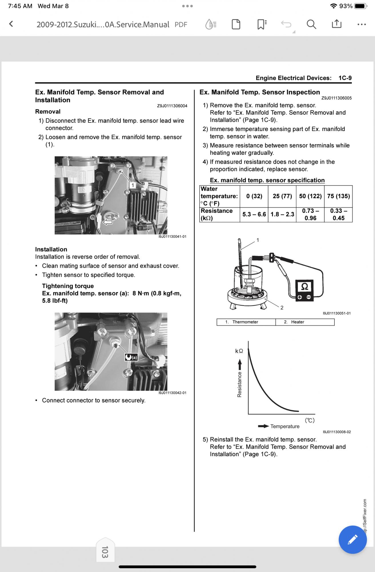

Below is a screenshot of the exhaust manifold temperature sensor test procedure from my service manual(DF70A-90A 2009-2012). Keep in mind that if your engine is 2004, the resistance numbers given might be different.
Your second sentence “Next it started losing power randomly and surging.” is the fail safe system kicking in, a 1-5 code will limit revs to 3000rpm. I honestly think you have 2 issues, VST “making oil” and an exhaust manifold temperature sensor is pointing you towards an overheating issue or faulty sensor.
