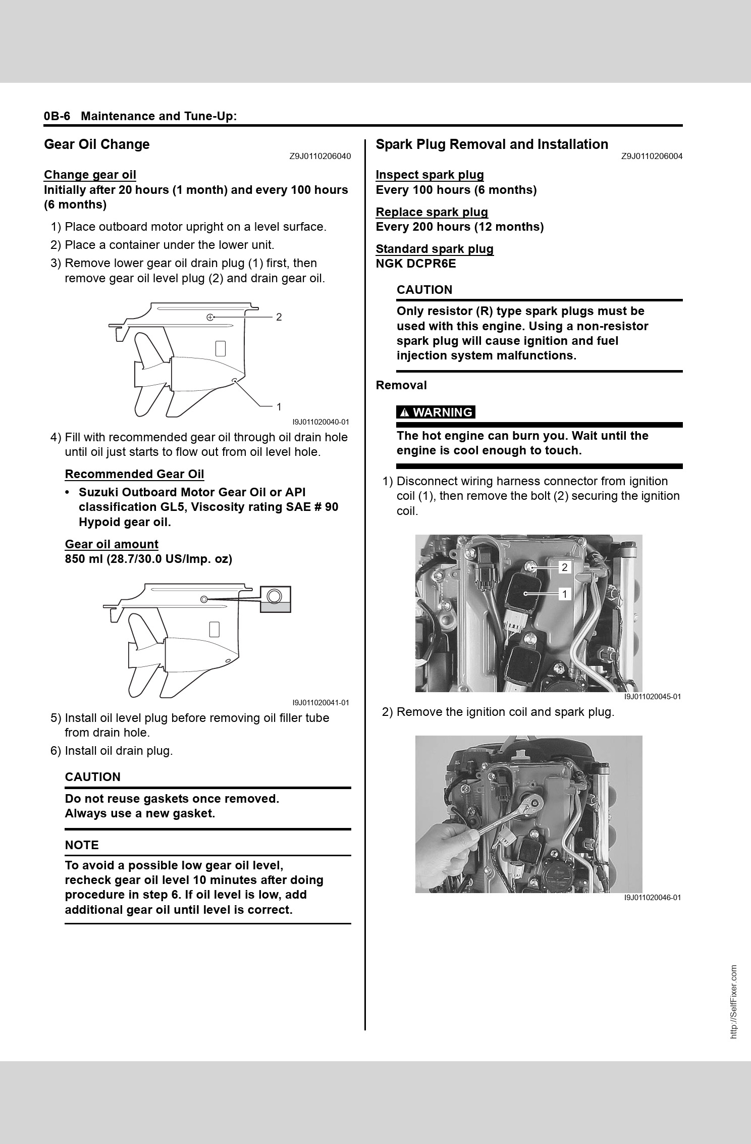

Have recently purchased a boat with a Suzuki DFA 25 2017. The seller told me that he had never changed the plugs, so I bought 3 new plugs, but cannot find where plugs are located on the outboard. Have changed plugs before on various 2 strokes I have had, but here I cannot find where the plugs are located and what I have remove to get to the plugs. Grateful for help - love from Linda
Screenshot from my 2009 DF90A, different engine than yours but the screenshot should be close enough to give you an idea what and where to look. In the tool kit that should have come with the engine will have a long spark plug wrench(about 6”) to reach the plugs. The standard plug wrench that comes with generic socket sets is way to short to work with your 4 stroke.
