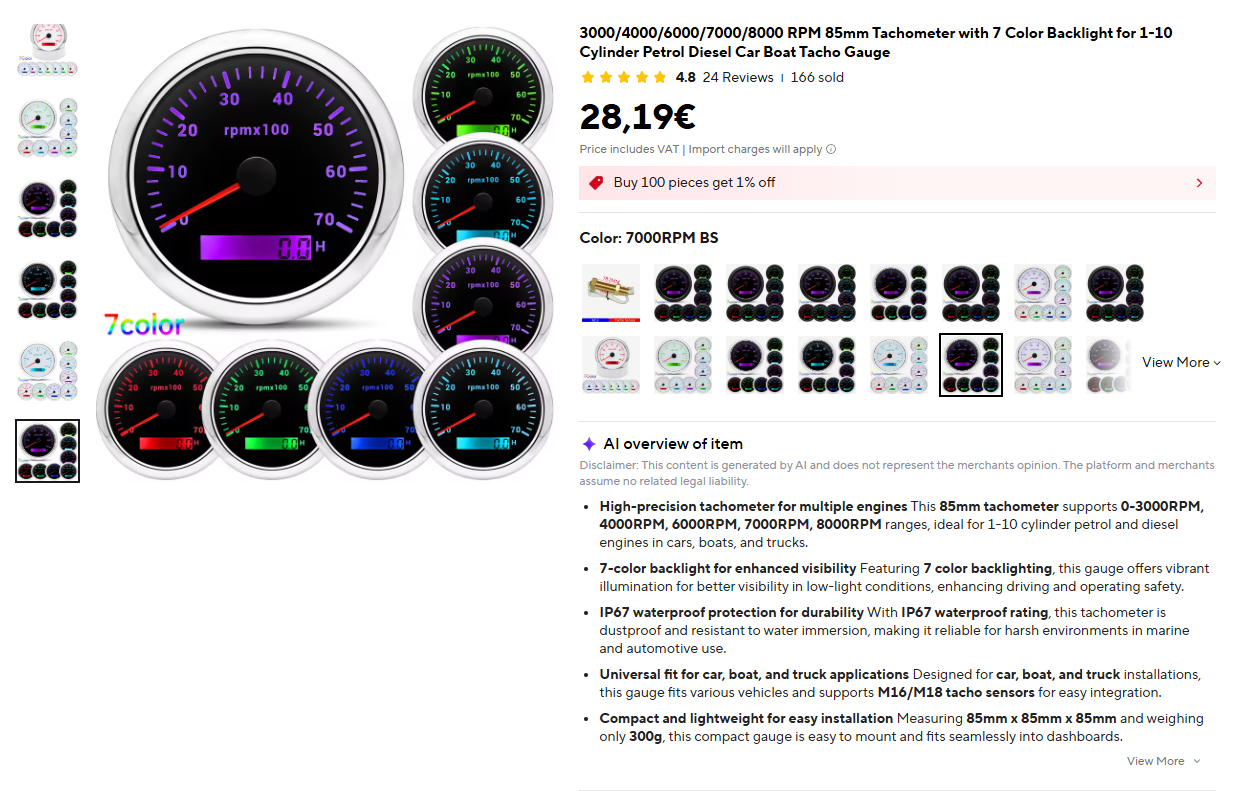

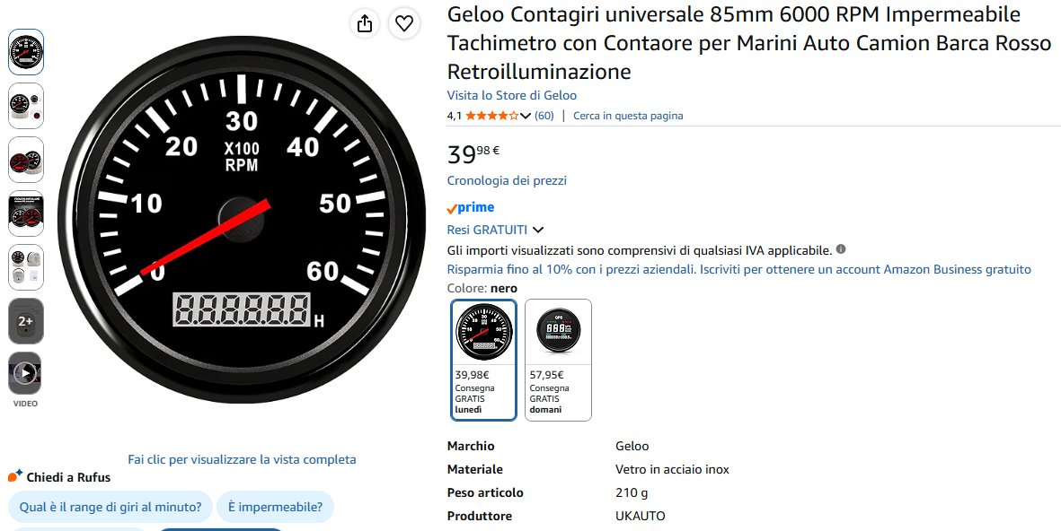

one from amazon, one from aliexpress.
i'm attaching a screenshot.

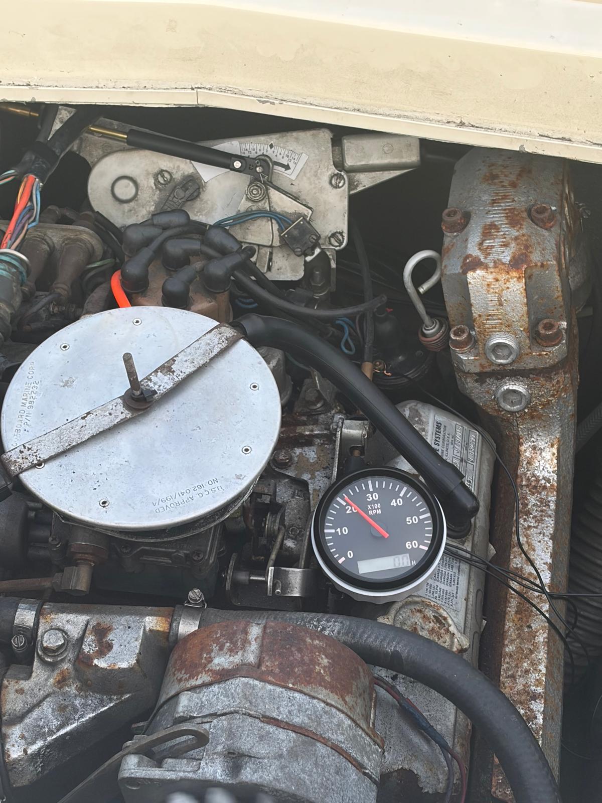

I’m attaching a photo of the tachometer showing 2100 RPM.
Great success! :D Finally, a step forward!

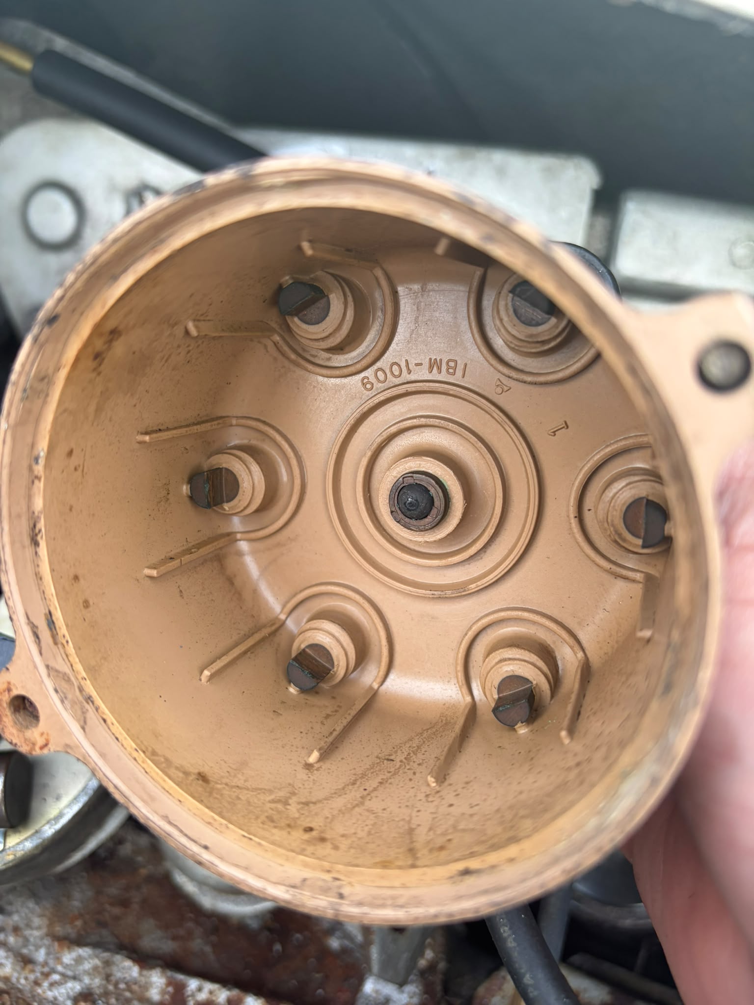

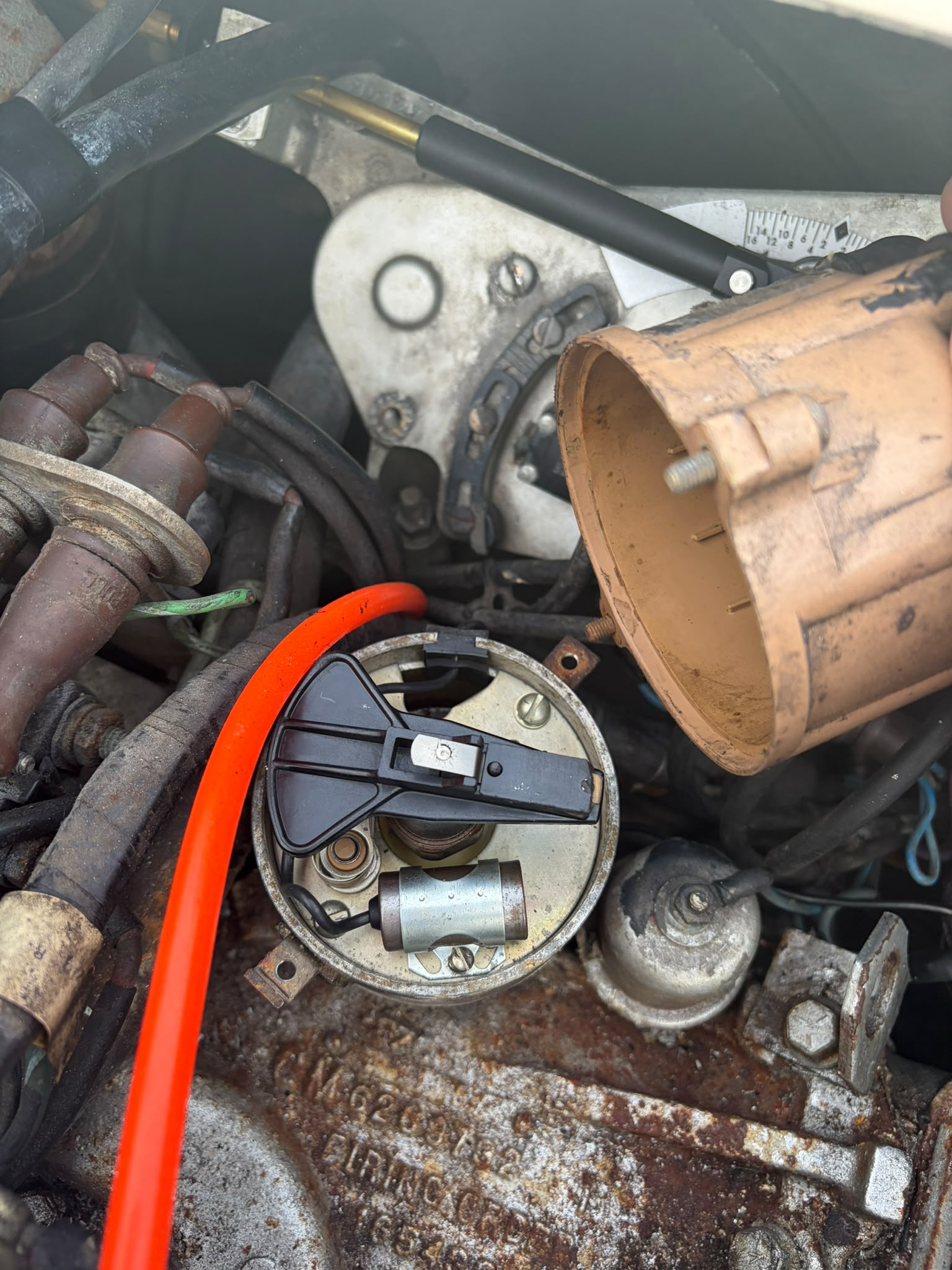

I think you probably have the same Prestolite centrifugal advance & points distributor that I have.
The boat is from 1985, but it’s actually almost like new. It only has about 50 hours of use.
The distributor looks to be in excellent condition. I’m not an expert, of course, but it looks almost new.
I can’t say for sure whether it’s the original distributor or whether it was replaced at some point for some reason.
