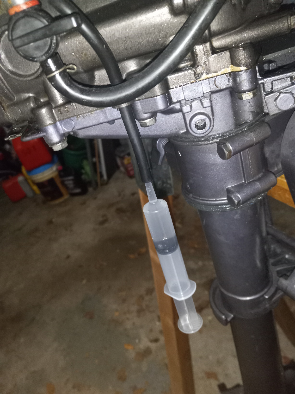

I tried some compressed air backwards through the outlet tube (that has worked in the past when the flow is poor) ...NOTHING.
I ran a wire up the outlet tube...NOTHING.
I filled a plastic syringe with water and put the tip into the outlet tube and put pressure on the plunger...NOTHING.

When I put pressure on the water-filled syringe plunger, it doesn't move at all...rock hard!
I am guessing salt/aluminum is totally blocking the passage...the question is "where"?
Here's the syringe...press fit.

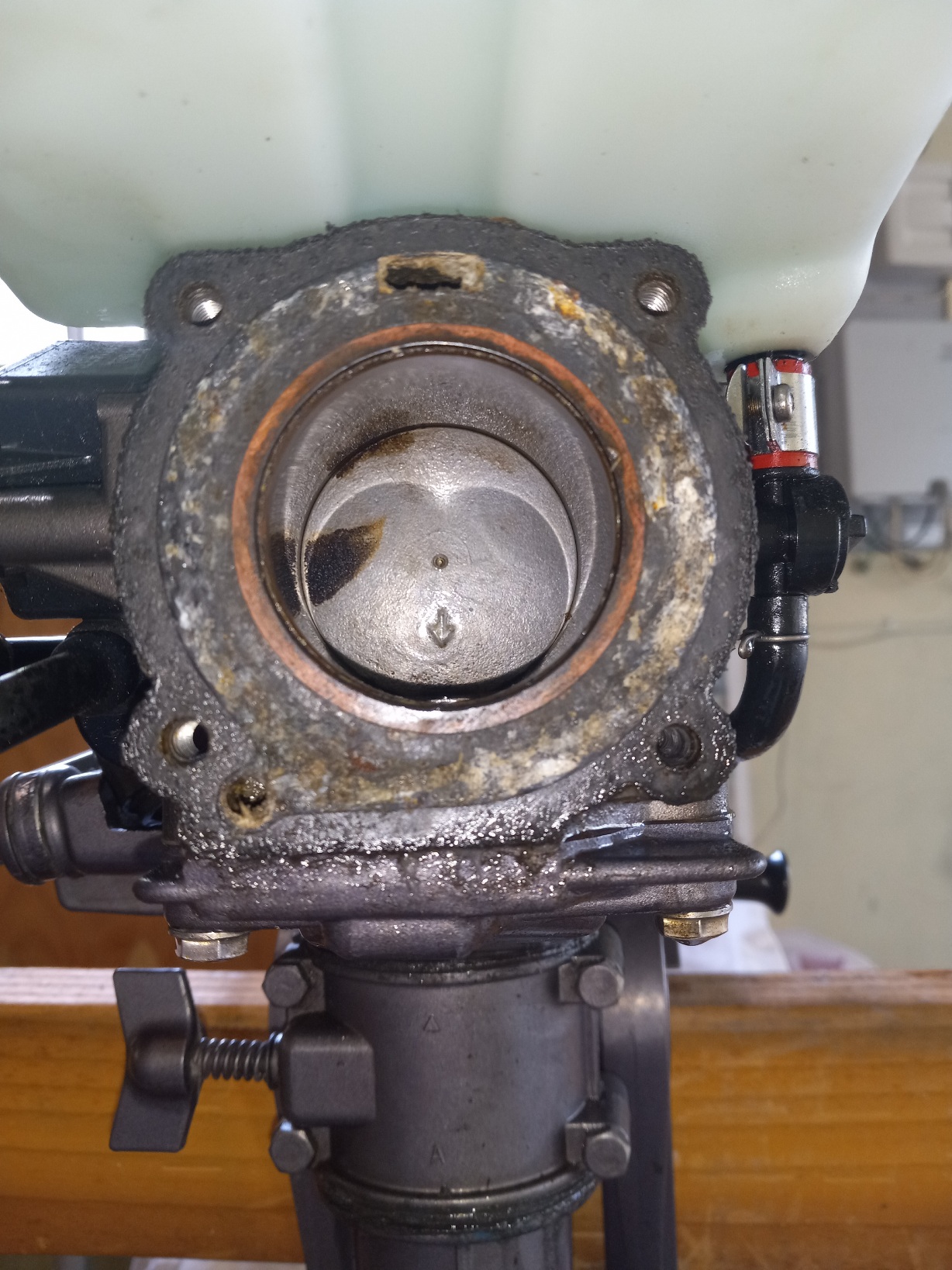

Well, I decided to dig deeper, again.
I managed to get all four cylinder cap bolts out
without breaking any of them.
Photos of the cylinder cap and cylinder with gasket in place are attached. Yuk!
The water passage in the cap is totally plugged
with salt and sand. When I took the gasket off
the cylinder, I found the water jacket loaded with
salt and sand. I took out maybe an eighth of a cup of the stuff with a small screwdriver.
Now, when I put pressure on the syringe on the
outlet tube, we get good flow. Hope this thread
may help someone else with the same problem.
