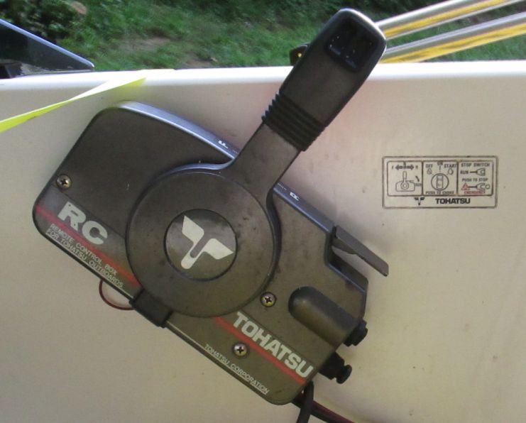

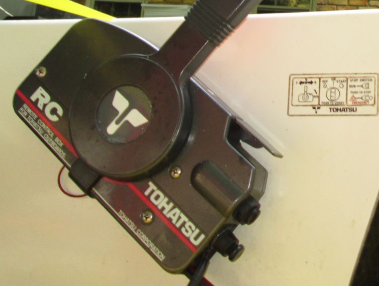

here are photos of my control box. I called Tohatsu.com and spoke to a tech and he said that
a knob protuded out of the front of the box that could be turned for friction adjustment. My control
box does NOT have a knob but there is a plastic plug that does not look like it was intended
to be removed from the outside. I would have to drill a hole in it and insert a screw to grab it
to pull out. I wonder maybe if I should take the covers off the control box by removing several
phillips head screws instead of drilling a hole and screwing in a screw in the plastic plug?

Your control is not equipped with the throttle friction screw. You should be able to add it. You will need items 40, 41, and 42 from the picture:
