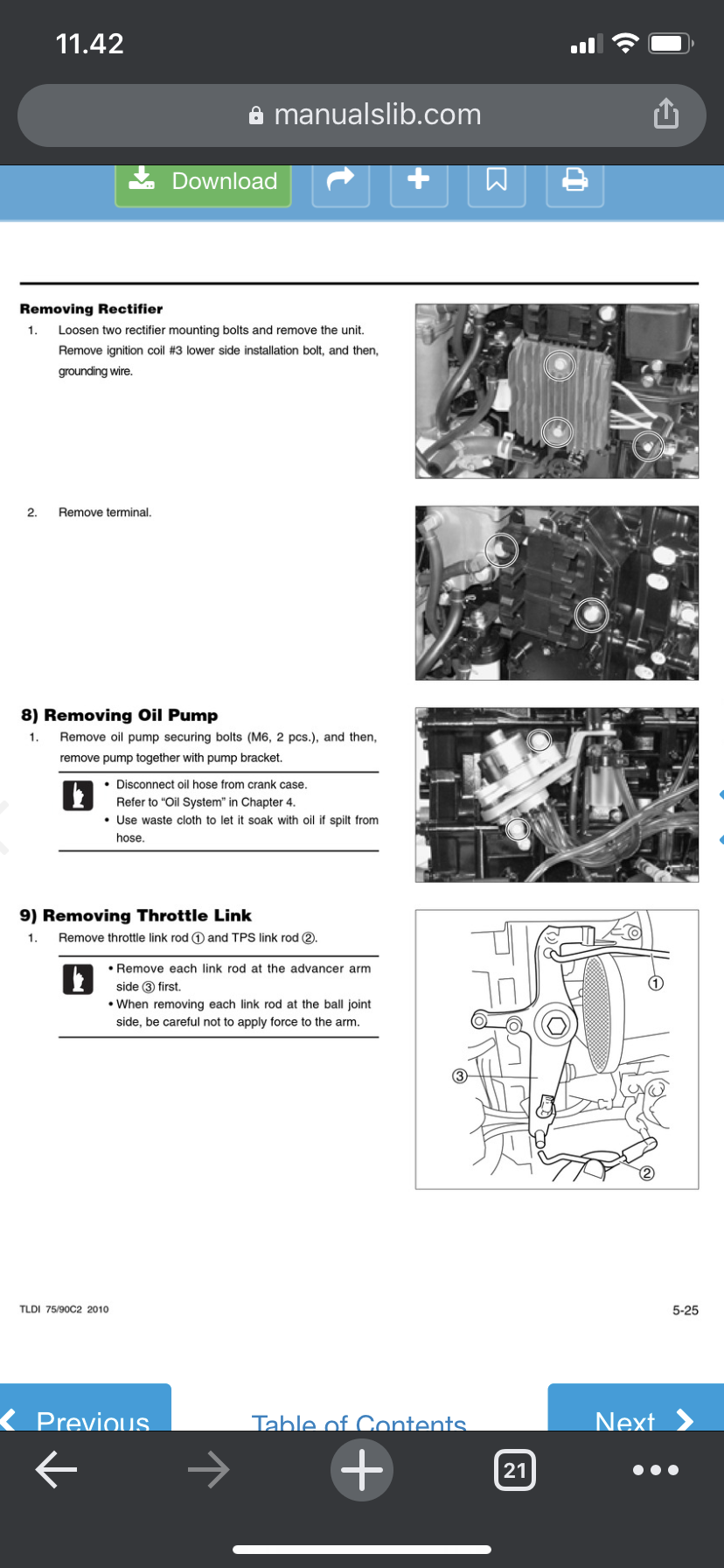

Full info is in the Factory service manual. You must use DFI oil, not just tcw-3.
Do you mean this throttle link rod? Image below. And by settings, that TPS is reseted when this rod hits it's "close" mark?
I've been using quicksilver DFI oil, made for optimax.

OK, 2% is about 50:1. That's OK at wide open, but should be a lot less at slower speeds.
I believe you have the electric fuel pump, which is controlled by the ECU, based on throttle position and RPM and load (vacuum).
The TPS determines when the ECU thinks the throttle is closed. The initial TPS setting must be right or everything else can be off.
Your videos show taking up slack in the various linkages; that's normal.
If you are still getting an oil pump failure code, the pump may be bad, dumping too much oil.
At this point, it's only a guess, but an informed one.

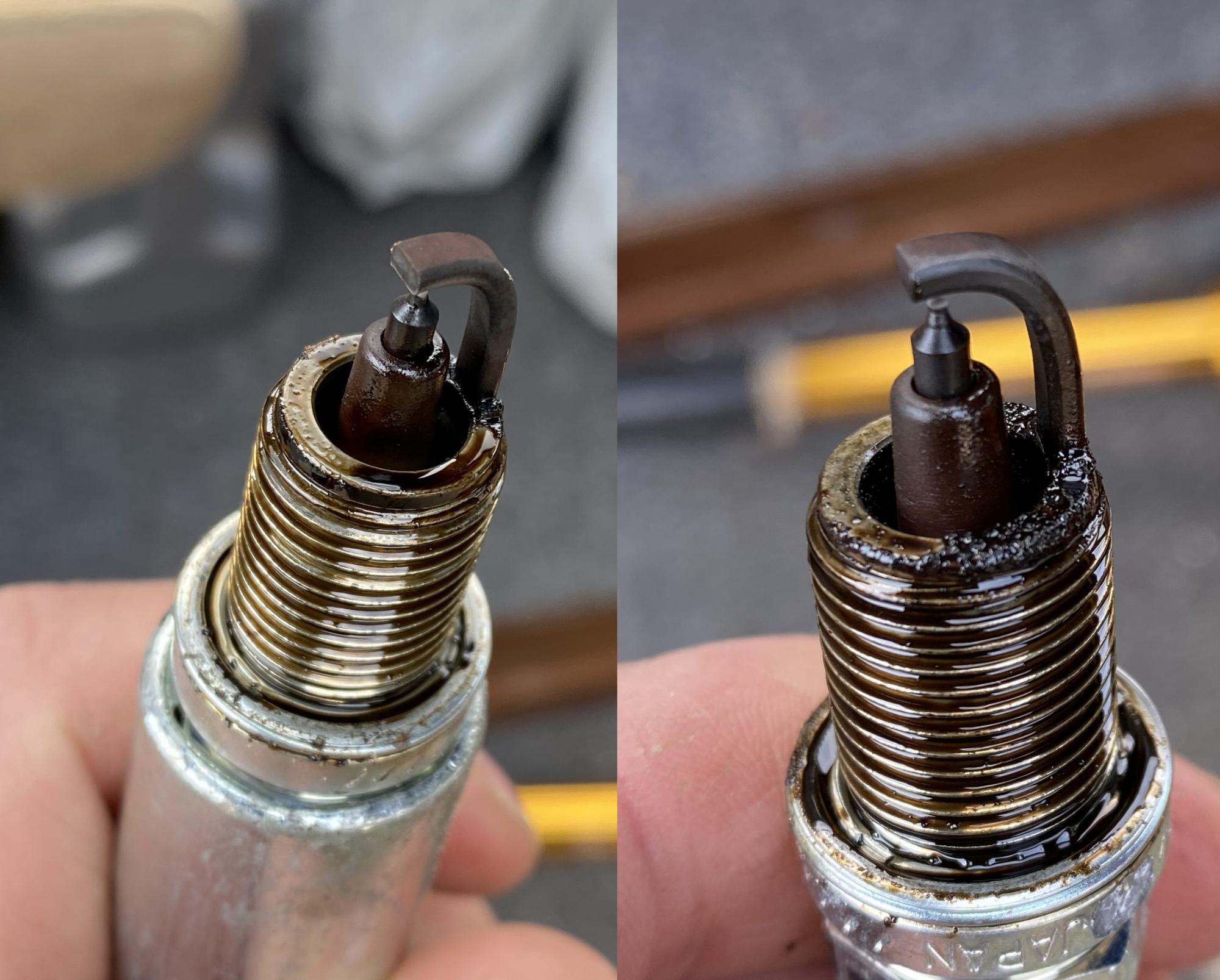

Thought the new oilpump fixed the problem. 2.5 h trolling and worked fine. Now two weeks later all ****ed up again. Dies when putting gear on. Plugs are like dipped in oil. What would be your next guess, pvanv? Im starting to think it’s the TPS sensor..
I read the faulty codes, it gave nothing. And reseted the TPS.

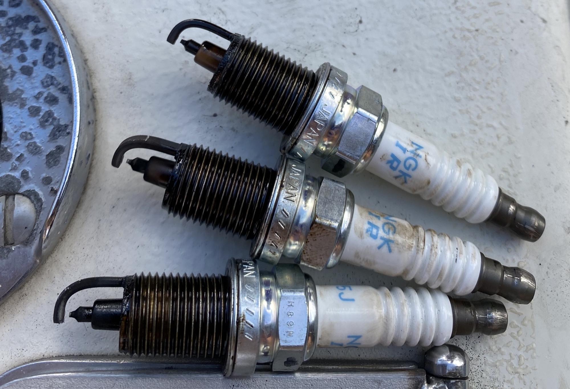

This is what the plugs look like. It´s 3. and 1. plug. nr. 2 was quite dry.
You can test the TPS sensor. I would also verify idle speeds. Check how much oil you are using. And clean or replace those plugs.
