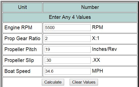

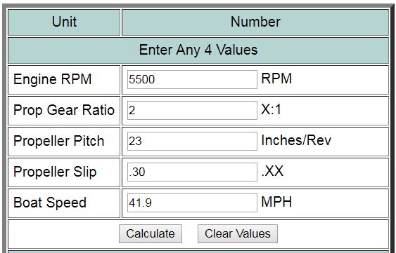

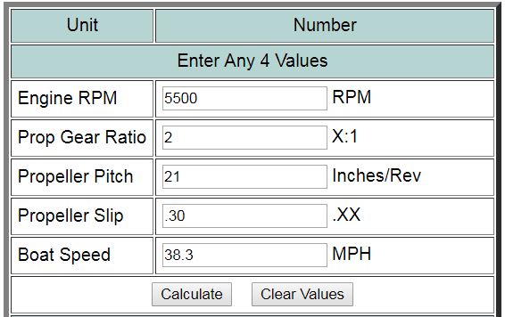

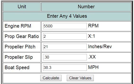

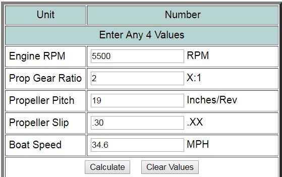

Below are some screen shots I took using an online calculator. FaztBullet speaks the truth, you're pretty much looking at a 4MPH gain for each 2" of pitch that you increase. It's just going to be trial an error to find the right prop that works. A cupped prop will act like a slightly larger prop, so if you're in between sizes you can try cupping to find a good middle ground. If you find a larger pitch prop that gives you the speed you want but low end performance suffers you can drill ventilation holes to help hole shot.
