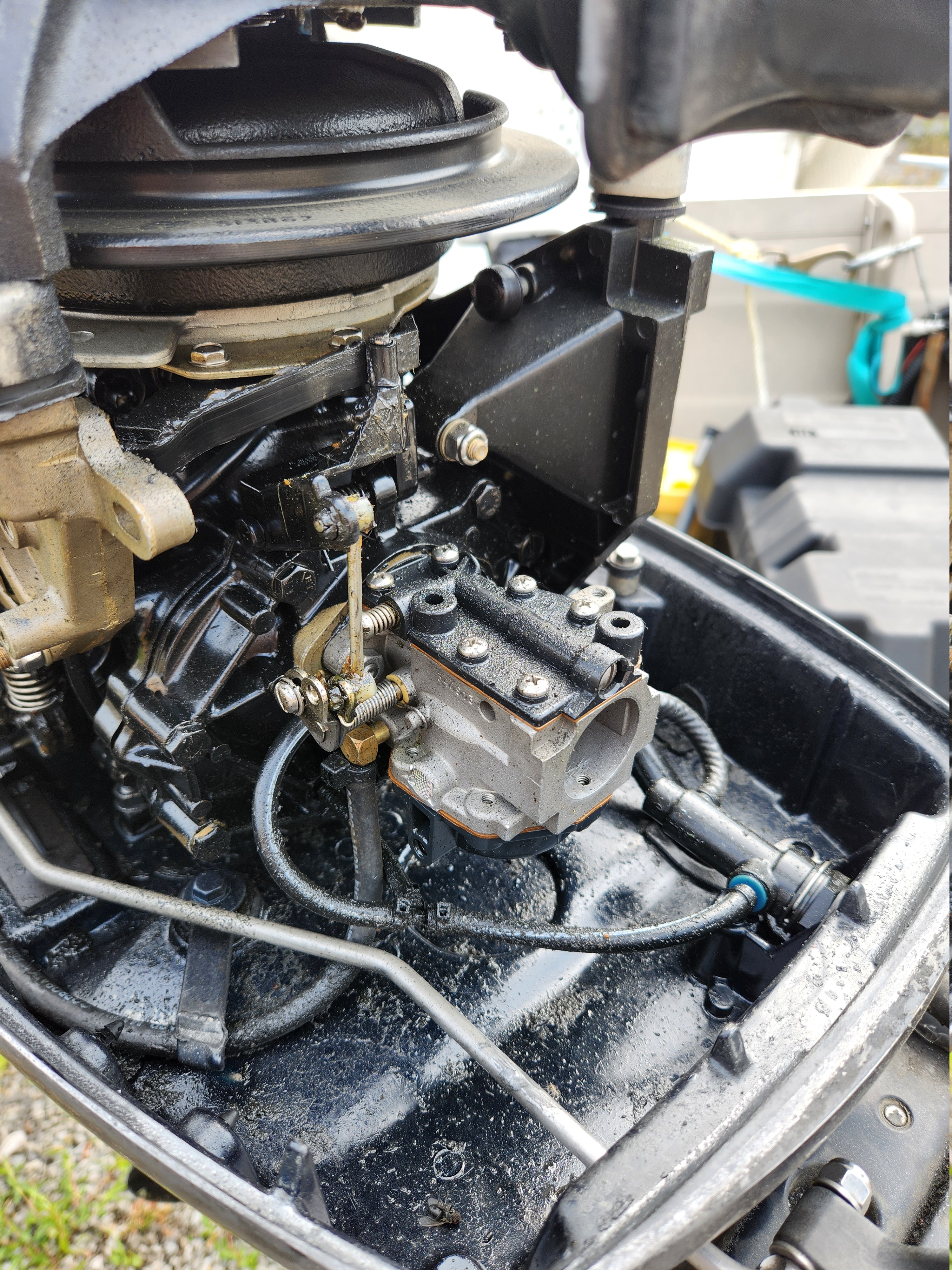

Trying to find out which carb i have on my 1997 20 hp evenrude 2 stroke so i can order the carb kit i see tthat motor came with 3 different carbs and the sticker on the carb is unreadable so if anyone can help that would be great.
mod number E20CREUM
SERIAL-G= 0426 7794
iv read this The correct original equipment manufacturer (OEM) carburetor rebuild kit part number for your 1997 Evinrude 20 hp E20CREUM is 431897 (often updated or interchanged with 439073).Rebuild Kit Part NumbersOEM Part Number: 431897 (or 0431897). This is the factory-specified kit listed in the official MarineEngine.com Parts Diagram for your motor.Alternative OEM Number: 439073 (or 0439073). This updated factory kit covers 1991–1997 20 hp models.
mod number E20CREUM
SERIAL-G= 0426 7794
