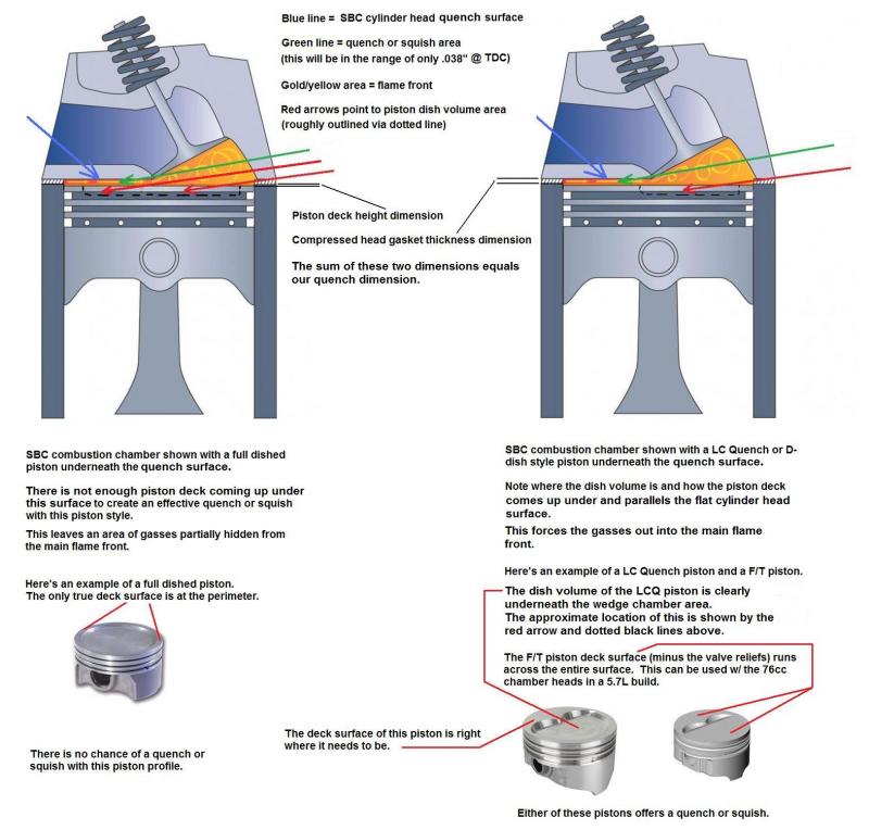

Quench effect or squish zone
Note the dotted lines that show the locations of the piston dished areas while underneath the "wedge" area.
Note where the full dished piston "dished" area is under the wedge.
In order to gain a quench/squish, the piston deck surface needs to "mirror" the wedge area best it can.
A Low Compression Quench, a D-dish, or a Reverse Dome style piston offers this deck surface.
(the flat top piston can also create a quench effect w/ a 5.7L build, but makes for an excessive C/R if used in the stroker build for Marine use)

Note the full dished piston at the bottom, and the two quench style pistons regarding the piston deck surfaces.
With a good quench dimension, C/R can be increased a point or two, and the ignition advance can also be increased with little concern for increased detonation potential.
More spark lead places the LPCP closer to 12* or 14* ATDC, where torque is born.
(if a lousy combustion chamber is created, ignition advacne must be held back, which makes for a lazy LPCP...... perhaps as late as 16, 17 or 18* ATDC)

1... fair question. I did plug in a value for a good quench dimension.
2... .054" to .064" plus the piston deck height, would remove the possibility for a good quench.
Take a comp/gask thickness dimension of .054".... add a deck clearance of .016", and were at .070" for a quench.
This becomes .080" if the compressed gasket thickness was .064"
I doubt that those numbers would even be good for a HP auto build.
The Marine cruiser engine build quench dimension can be around .038".
I believe that the auto guys are shooting for .045" or so, and this includes the piston deck dimension.
3... yes.... you are correct.
If I toss in a comp/gask thickness of .054", and use the values as before, the S/C/R comes to 9.4619:1
But where did the quench go?????

Without a good quench, ignition advance is held back as to avoid Marine load detonation potential.
When Ignition advance is held back, LPCP is also pushed back.
Give her a good quench, and we can now also give her a bit more ignition advance, of which brings LPCP to where it needs to be for better torque.
The interesting thing is.... this is so dang simple to do! It simply involves a different piston profile selection.
All else can remain relatively the same.
The Chrysler Wedge Head boys have known about this for years.
Hell..... GM knew about this back in 1955 with their first 265 cu in OHV V-8.
The basic cylinder head design has not gotten away from the wedge area.
Look at this piston deck coming up underneath the wedge area.
The 70's emmissions control requirements threw us out of whack with that silly full dished piston........, and only a few of us have recovered!

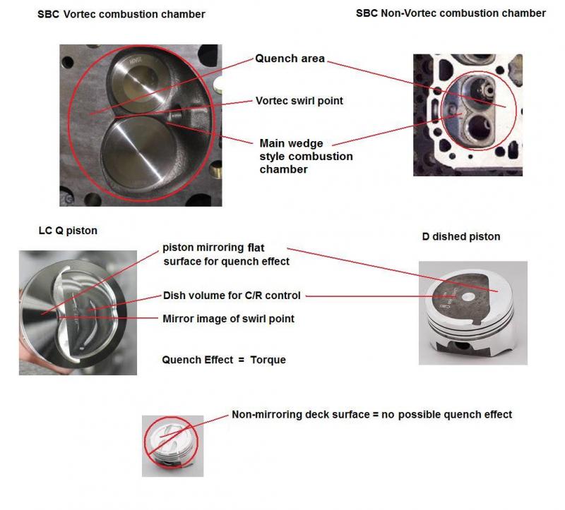

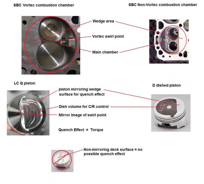

Bill, agreed! Ya gots ta get sump'n com'n up under da wedge area, in order to squish and push dem dar gasses out into the flame front. :D
However, my take is that the D-dish is not quite as suited for the Vortec chamber, as it is for the Pre-Vortec chamber.
The Reverse Dome refers to the Negative piston deck volume. To be fair, both the LCQ and Reverse Dome have a negative piston deck volume.... so I guess both could be called "Reverse Dome", so to speak.
Below is a D-dished piston (left) and a full dished piston (right).
The D-dished could also fall into the Rev Dome category, but the "D" references the deck shape, and somewhat sets this piston apart.
The D-dished piston is actually a good candidate for the pre-Vortec chamber... given the correct dish volume per combustion chamber volume.

Here's the issue (although not huge) with a D-dish or Reverse Dome piston with the Vortec chamber.
Look at the Vortec wedge area swirl point below (left side). Below this is a LCQ (low compression quench) piston.
Note that both the piston deck and wedge area are above and below one another.... more or less mirroring each other.
Note how this piston deck more closely mirrors the wedge "swirl point", whereas the D-dished piston cannot mirror the swirl point.
Now look at the pre-Vortec chamber (right side). Below this is a D-dish piston.
Note that both piston "D" and wedge "D" shape are above and below one another.... more or less mirroring each other.

I need to qualify something here that I've not quite been clear on.
The term "wedge" actually pertains to this style combustion chamber shape.... meaning that a "cut view" of this chamber would resemble a "wedge" shape, shown in the image below.
The flat surface off to the side of the main chamber is where the quench or squish occurs if/when this area covers a substantial portion of the piston deck, as it does with the SBC cylinder head, the 5.0L and 5.8L Fords, and the Chrysler wedge head engines.
This would be the area that I've referred to as the wedge surface.... when actually it should be referred to as the quench surface.
Hope that makes sense! :D

I've changed some of the verbiage only in these......... the actual images are unchanged.

Wedge style combustion chamber with very little effective quench surface, if any.
I have no clue as to what engine this represents.
