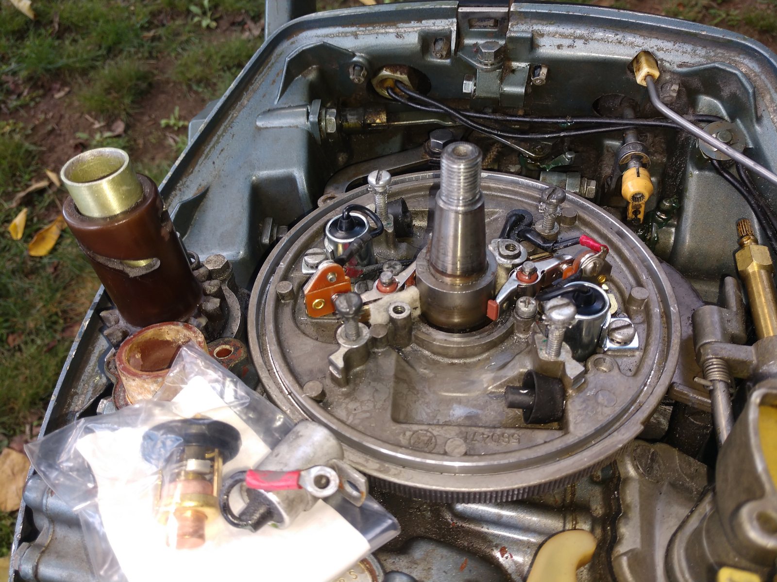

I learned how to use the timing fixtures when I was a teenager doing most of the tune-ups at a Johnson dealer.----Nothing to it !---Any pictures of this motor ?----Magneto plate comes off easy in my opinion.----And you have to take it off to install coils / new sparkplug wires.

Why not compliment the refurbishment by replacing the head gasket. It appears in your pic that some corrosion is accumulating at the gasket seam. I replace the gasket on my 9.5. Quite simple and good insurance on a Aged motor. Torque values and bolt sequence tightening can be found in service manual or internet search. Great motors.
The early 64 and 65 models suffered from a lot of shaking at idle.-----Factory came out with a damper kit.-----I installed more than one of those kits in the late 1970's---I do not see the kit installed on this 1964 model.----Yes the later 67 to 73 were great motors. with the shaking issue resolved.
Just 2 more screws , a wee clip , a pivot bolt and the plate lifts off.
That's something I. Have been considering. Now I'll order the head gasket. Thanks for bringing it up.
