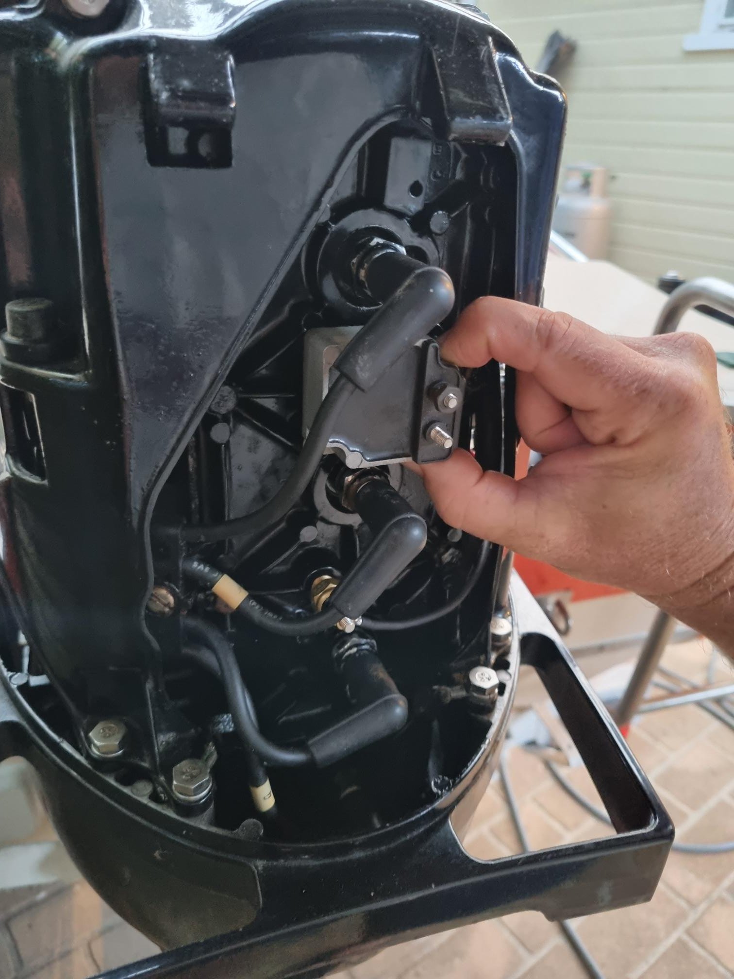

Thanks for the pic, how have you mounted that? under the engine cover or external. As you know space is very limited and the heat build on the components.

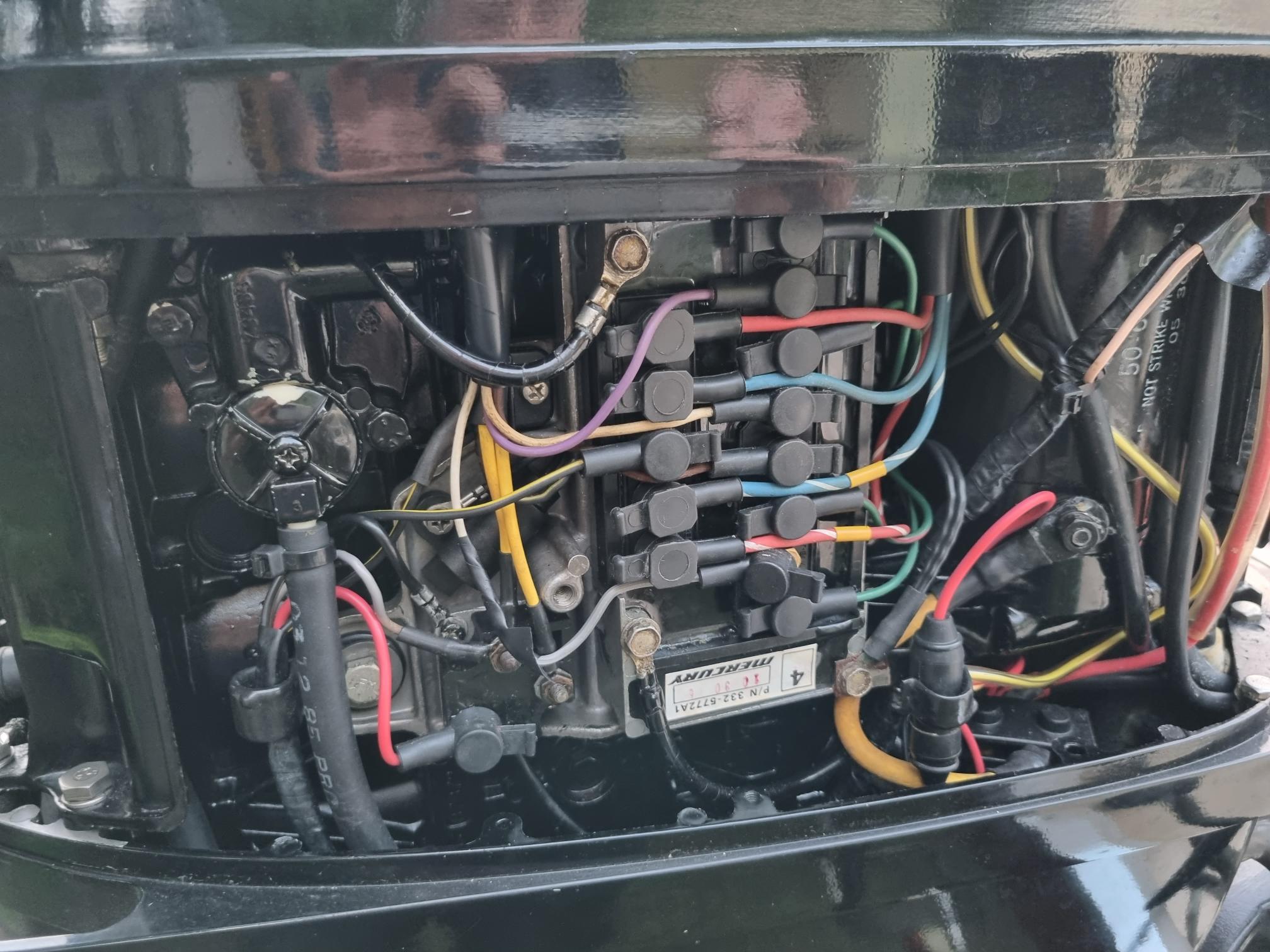

Thanks for the information. I guess the original was just a rectifier, but need to get the voltage down so was just looking at the regulator to add in. The S/N 9453744, Belgian made 4 cylinder. As you can see there isn't a lot of room.

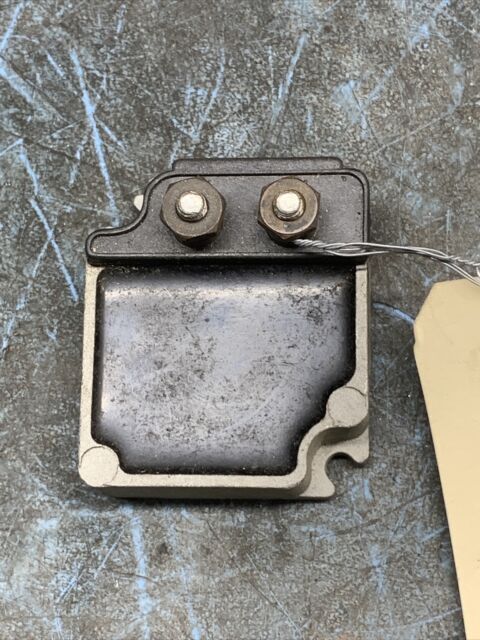

Here is a link to an Ebay seller that is offering the conversion kit. You might want to see if he will send you a copy of the kit installation instructions so that you have better visibility of how it is installed. What goes where.
That module kit (OEM) is a clipper or you could call it a regulator as it bleeds excess voltage to ground . The CDI kit posted is a rect/reg
The CDI unit is a rectifier/regulator assy and the Merc OEM kit is just a regulator/clipper add on. The CDI unit works by comparing the actual output voltage with a reference voltage and using feedback to adjust the output voltage as necessary.

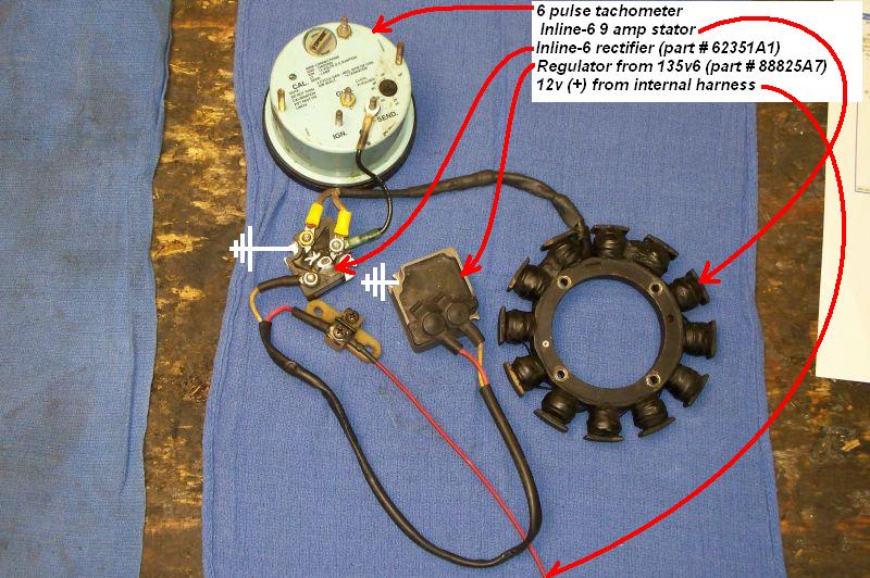

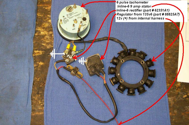

If I am now understanding this correctly, the Mercury part gets added to the existing rectifier. That is, two separate parts doing the job of what one integrated rectifier/regulator does.
Which would agree with the configuration shown in post #2.

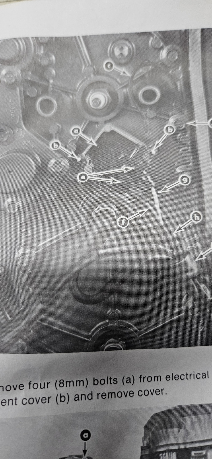

It needs to mount on a flat bare aluminum area as it does get warm and needs a good ground to bleed current to. Flat area above exhaust would work.
Yeah I was planning on doing that and possibly looking at an aluminum heat sink. I can imagine it gets very hot under there. This is the position in the pics from the manual. there are already the two mounting points cast into the head to suit.
This is from the documentation if anyone is interested.
