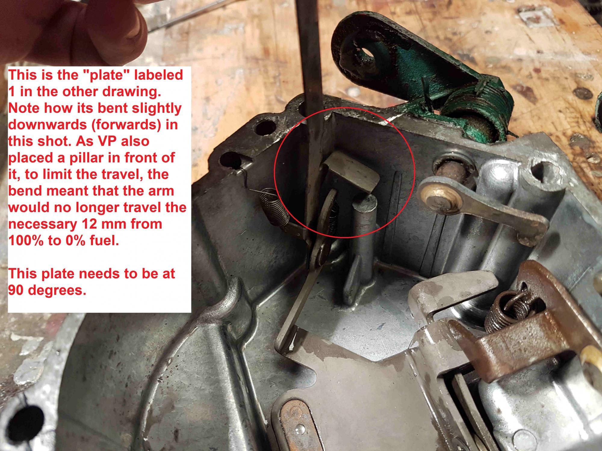

Well, I actually ended up replacing the entire engine with a Yanmar, but that was due to water ingress in the cylinders and seized pistons. Without cylinder liners, fixing that particular problem would have been a nightmare. The engine was a bit on the small side for my boat anyway, so...
On to your problem. Before seizing up, I did figure out what was wrong with the centrifugal regulator for the fuel injection pump. As you mention above, there was a thin metal flap which had been bent to about 45 degrees, by operating the manual stop lever while the fuel pump control rod was stuck. The effect of this was that the centrifugal regulator couldn't provide enough travel on the fuel pump control rod to prevent a runaway engine, and secondly, the manual stop lever couldn't push the fuel pump control rod to 0%.
Hope this drawing makes this a bit clearer:

Thank you very much I don't know where you got the drawing but have been looking for that all over the web. that's exactly what my problem is I couldn't explain it to any of the experts over the phone no one seemed to get it I guess it takes someone with experience on that exact problem to help I really do appreciate it I can put my engine back together with confidence now
No problem at all. I recognize the problem with the "experts" on the phone. When I told them it was a tiny MD2030 from the 90's, they suddenly couldn't help me anymore.

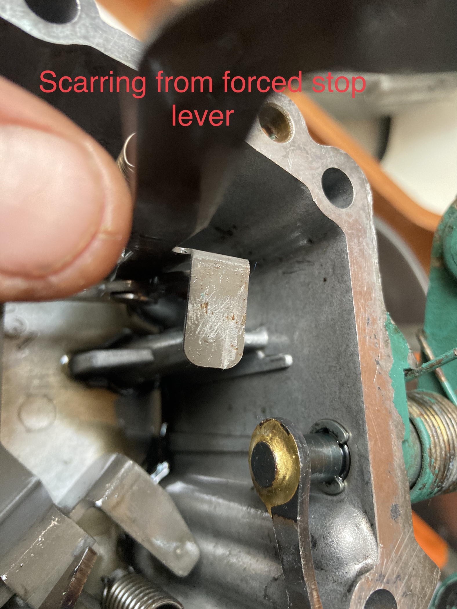

Hello,
Been a couple of years since this post but want to say thank you! This is exactly the issue I had with an VP MD2010.
Some background, boat had been sat idle for 11 years we think, changed all filters, oils, fuel, fuel tank was gross. But a bit of easy start and away she went……but wouldn’t stop. 4000rpm came up and managed to stifle her by blocking the air intake.
Spoke to a lot of engineers, 8 in fact. They all said the governor would be stuck open, a good friend of mine who was with me suspected the fuel injection pump. Straight forward enough to get the fuel injection pump out, first specialist told us was knackered and needed a new one. Wife wouldn’t let me buy a new one! Thank god! Took it for a second opinion. What a legend, cleaned it up and told me to bugger off! Said there was some varnishing and the fuel delivery valve was stuck open, but nothing wrong with it.
That’s when I found this forum. My intermediate lever had a near 45degree bend on it rather than 90. Straightened it and rebuilt. Hardest part is the water pump!
Started her up, ran and purred like a kitten. Didn’t run away at all, sat at idle, brought the revs up to 2000rpm, then she dropped right back. Perfect!
What caused it to bend is what is frustrating me. I had an “engineer” jump on whilst we were trying to start it, he was ramming the stop in and out. I questioned at the time why, shuts off fuel not decompress so couldn’t see his logic. So I think the fuel pump was stuck, then ramming the stop bent it. But unfortunately we’ll never really know. But the bend lever arm was absolutely the cause to it running away. I hope this helps anyone else who has the same problem.
Many thanks again!
