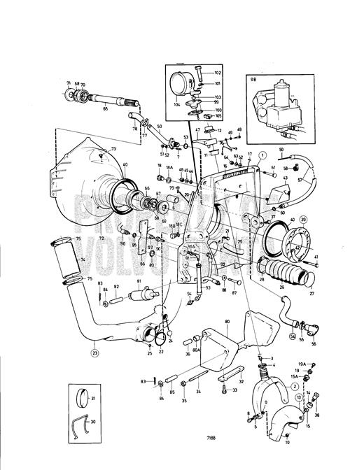

Hate to start a thread for it, but I've poured over Google photos and can't find anywhere that indicates where the wire that hangs down behind the steering helmet actually hooks up for the trim indicator.
For reference, wire hanging under part number 104

View attachment 23180The cable or 'wire' clips to the small vertical linkage on the left side about where the helmet piviots,,hope this helps.

Thank you! That helps immensely!
