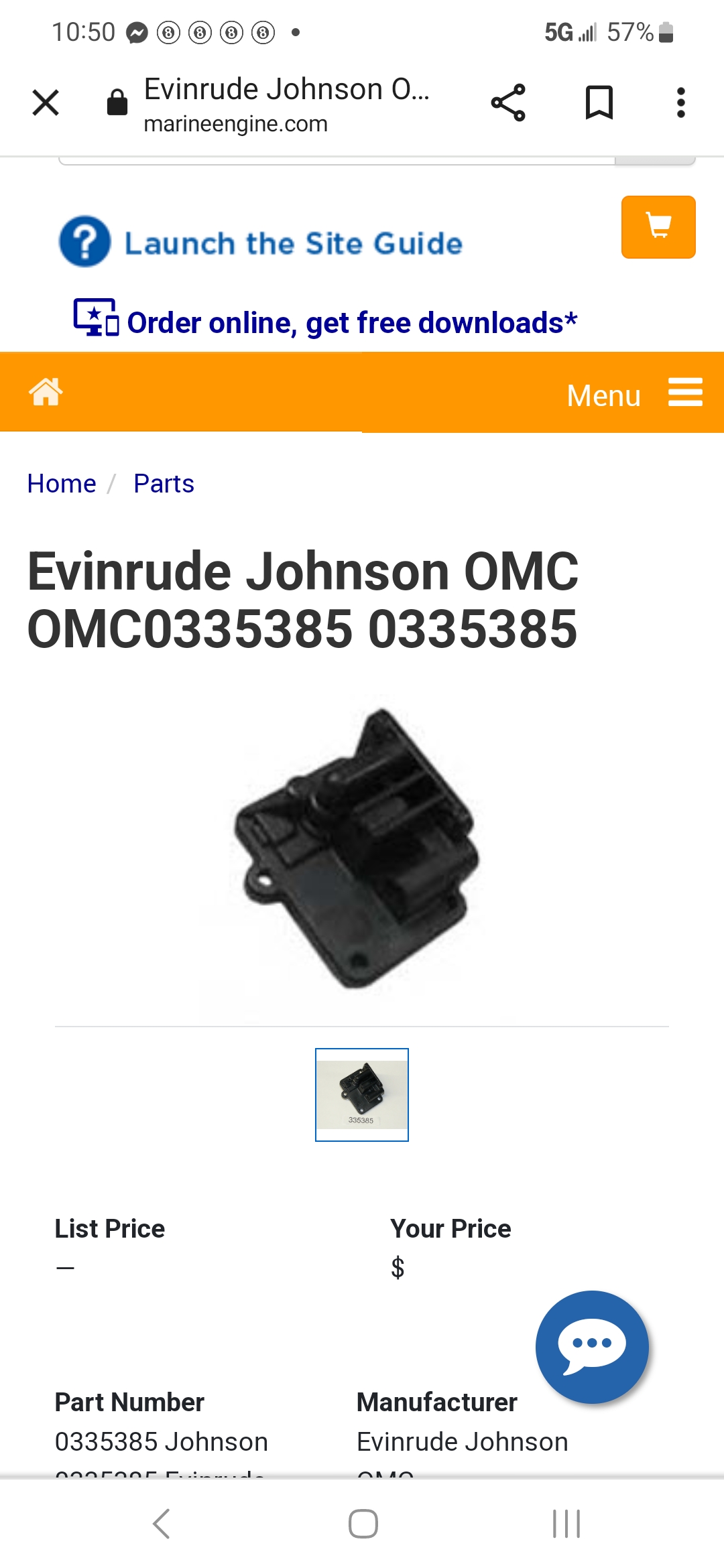

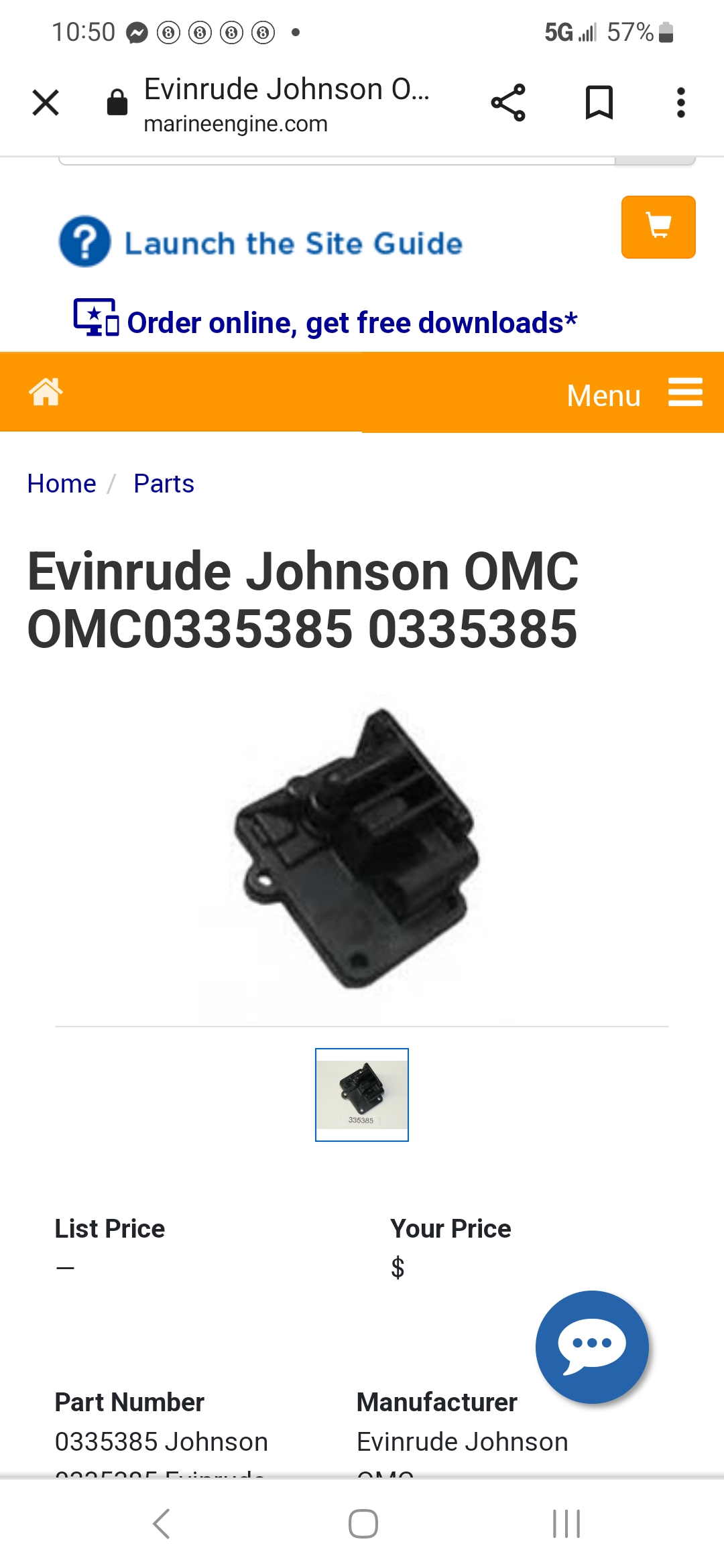

The fuel separator. Top is warped causing it to starve for fuel figured I would do away with it they are hard to fine
Let me ask this do I need the separator to supply fuel or can I run my fuel lines to the fuel rail that plugs into the side of the carburetors?
It looks like it 2001 90hp johnson
