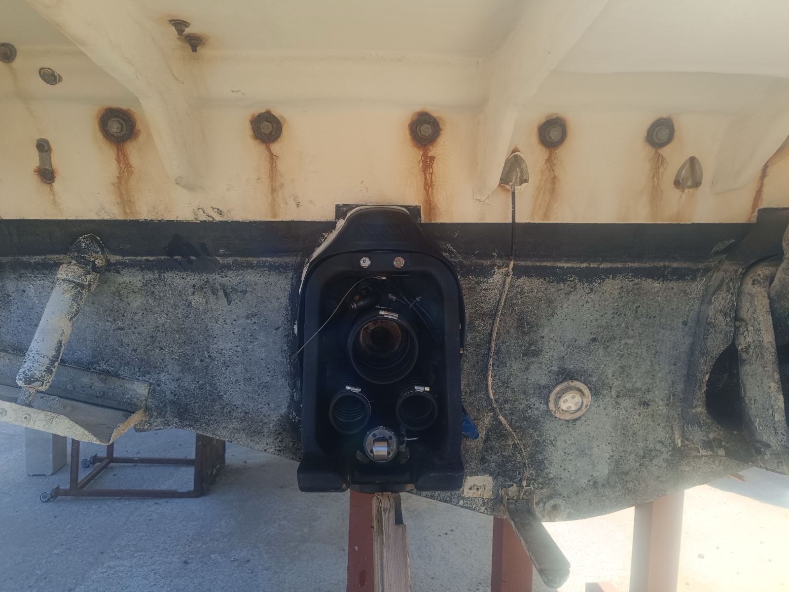

Hello Captains! I’d like to share my headache with you.
Last Tuesday, I returned to the marina and noticed that the bilge pump was discharging water. About 10 minutes later, it happened again, so I went to check the bilge. I saw that water was coming from somewhere behind the port engine.
Because of the boat’s construction, it’s difficult to find exactly where the water is coming from. After some time trying to locate the source, I decided to lift the boat.
Now, to be honest, I don’t know what to do. The boat is in dry dock. My mechanic, who usually services it, came to check but couldn’t find anything. He said, “Sorry, I can’t find the source. The construction of this boat makes maintenance very difficult, and I don’t want to work on it.”
To be honest, I understand his point—but what can I do? We have what we have.
Since I bought the boat, I’ve noticed that from time to time, after returning to the marina, there’s some water in the bilge—about a bucket or so. I clean it, and the bilge stays dry until the next trip. But now it’s leaking constantly, regardless of whether the engine is running or not.
Maybe someone could share their thoughts on what it could be?

Put the boat back in drydock and try filling the bilge with water and see where the water comes out of. That's a pretty good drip so it should be easy to see. I'd be looking at the engine to sterndrive bellows as a possible source, which should be able to repaired from the outside on drydock. The sterndrive unit itself is not highly regarded.

Thank you, but filling the bilge with water could actually be the problem. In my opinion, the leak itself is not at the bottom but somewhere around the middle of the boat, about 20 cm higher.
The mechanic also mentioned the holes that were sealed with silicone after the transom transducer was removed, but those seem to be lower than the point where the leakage is coming from.
Are there any hoses between the drive and the engine? Cooling hoses maybe? Could water come in even when the engine is off?
Last year, both drive bellows were replaced, but the exhaust was not changed — the mechanic said they were fine.
Ahh… about those last two points, all the mechanics told me the same thing! I guess I’m lucky — what can I do? 🥹

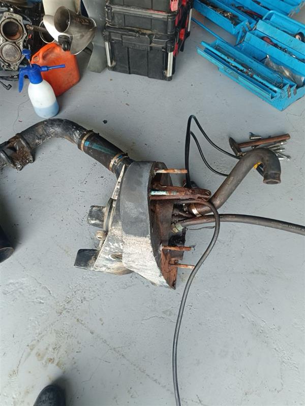

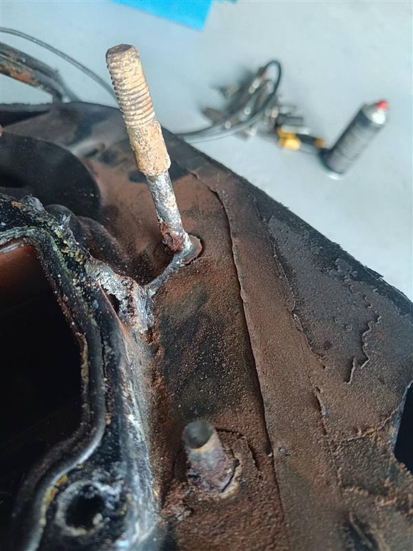

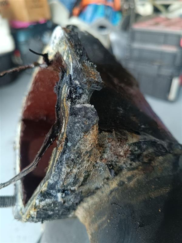

Hello, Captains! I plan to remove the engine to access the transom. Do you have any recommendations for what else we should check and replace, since some parts are easy to reach once the engine is moved?
hi did you find out where the water is leaking from? I have the same boat and same issue water in the middle part of the bilge

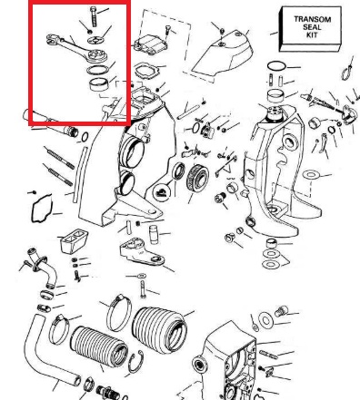

Hi Joseph! Yes, I found the issue. The problem was a leak in the port side transom. Over the past two years, I had noticed some water entering the bilge after going out and returning, but only now, when the leak became so fast and severe, did I start investigating.
Unfortunately, in our type of boat, there isn’t enough space to inspect the area behind the engine, so it was decided to remove the engine, which proved to be tricky. The result is that during the leaking, everything was corroded the Y-pipe, the transom bolts, and everything around it. Therefore, I had to find a used transom and reinstall it.
In my case, the problem was the part highlighted in red in the photo, but in any case, to replace it, the engine needs to be removed. Removing the transom requires taking out the engine, which is a big job.
If you remove the engine, it’s also a good opportunity to service it. I have now replaced the ignition coil due to corrosion, as well as the fuse box, Y-pipe, and all seals. I’ve also decided to replace the manifolds and risers on both engines.
