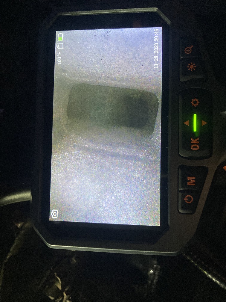

I found a way to look inside the elbows with an endoscope camera, by removing a plug in the top of the elbow that VP used for an exhaust temp warning system but any removable plug in the elbow could work. This way after running it, no guesswork, you know if it leaks inside or not. Being that you have a Merc, you could eventually switch to the dry joint system if you wanted too, it's just expensive and you just bought the ones that are on there.

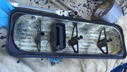

Here's a pic of inside the exhaust elbow, after about 4 seasons in salt water....
