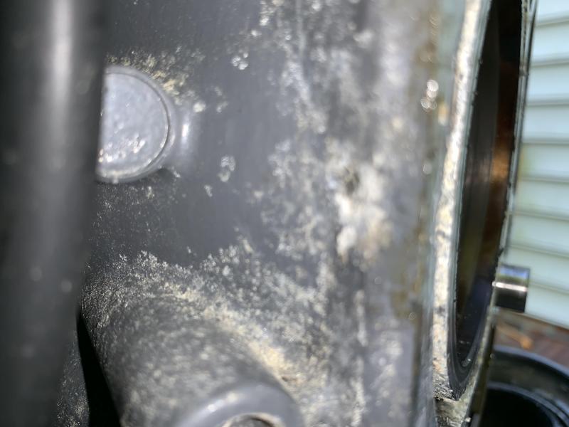

Well after replacing the VST and the motor running really well, today I ran the motor with garden hose to just check everything was fine before going fishing tomorrow, I discovered a major water leak coming from behind the fuel rails. It appears to be a hole in either the cylinder head or the block itself. I think it is the block. See attached pic. This is looking down from the starboard side of the engine.

You can try a patch up to keep it going but it's temporary and could cause engine failure anytime. Usually one would replace the motor or repair by fitting a new power head.No magical fix I'm afraid, another victim of salt water.
Thanks for the reply Ian. If I can patch it up and maybe get the rest of this season out of it that would be great, and then over the winter I will repower with new motor.
So far I have remove the cylinder head to access the area where the corrosion has eaten 2 holes at the top of the short block, right where the cylinder head meets the short block. I used JB Weld Steel Stick to make repairs after cleaning the corroded holes with wire brush.
I will be putting everything back together today and give it a test run.
I will post some pics later.
Everything is back together and the JB Weld worked just fine after running the motor hooked up to muffs, no leaks.
Here are some pics of what the corrosion looked like after I removed the cylinder head and cleaned up and then with the epoxy applied to it.
The corrosion created what looked like a bridge across from the side of the block to the cylinder outer wall, sorry I didn't take a pic of that. While removing the corrosion, I noticed a second hole just starting to form in the same spot on the number 2 cylinder. Cleaned and applied JB Weld to both holes.
