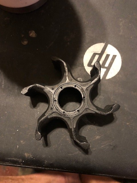

Well, my youngest son described my overheating issues with his father-in-law, who is a Yamaha Master Tech, and known for being "the guy" to go to for Yamaha issues. He heard my son describe the problems I'm having and said, "Sounds like he needs to replace his water pump to me." That was pretty frustrating after I spent the winter working on resolving the problem. I relaced the water pump, ran descaling solution through it, checked thermostats in a pot of water on the stove, repaced poppett, and finally removed the exhaust cover and cylinder heads to clean all the crud out of the water jackets. BUT, just for fun, I removed the lower unit just for fun and the impeller is TOASTED!! I Replaced the water pump before I ran a lot of descaling solutions through it. AND, I purchased and aftermarket Non-OEM water pump! The impeller is all gummy and soft and deteriorated. I've never seen an entire stainless insert that the impeller fits in that is completely black and coated with gummy rubber stuff. I have no idea what happened to this impeller, but I'm guessing that some of chemicals that I poured into a big drum to run my motor in just ate up the impeller. Pics attached.

Someone on another forum asked if I had a live well and if it had a plug in the bottom. He said he had a similar problem and all logical fixes didn't work. Somehow he figured out that the through hull overflow for his live well, at a certian speed was sucking air through the overflow and causing a cavitation issue between the transom and the the water pickup on the lower unit. I can actually see that happening. My live well is under a set at the back of the boat. I don't have a plug in the bottom. I store and anchor in there and the lid doesn't close completely because of the anchor rope coming out of the live well and under the lid. I can picture how that could happen. I never run the motor without either being in the water or on muffs.
