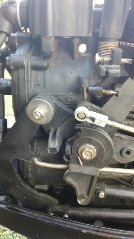

Is my 25 Hp Mercury block the Mercosil block? I'm wanting to rebuild it but not sure what block I have. My serial # is 0D293494 If it helps.

What does the big M stand for?
M=Mercury. On the #1 cylinder, that is the top one, over on the throttle assembly side it will say either Mercosil or nothing. It is physically cast into the block if it is there.
