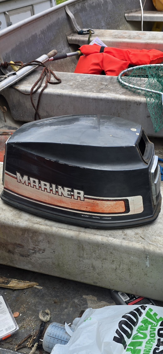

Anyone know what year this is? And where to get a service manual? I picked it up cheap and not running. It would drop the top coil at idle. After lots of farting around. I cleaned points to discover a homeade woodruff key that was loose in the slot, assuming it let the flywheel (and timing) move. Which it broke and I made another one while I ordered more. Anyway. Can anyone help?

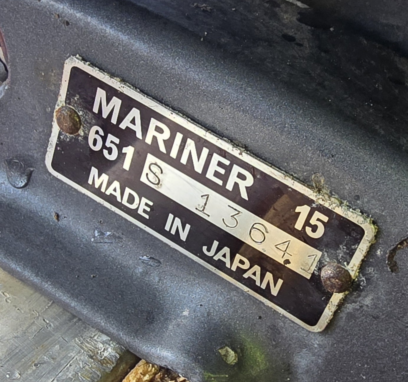

What is the engine serial number?
It is going to take a very sharp man to identify a model year by a photograph of a cowling.
Circa 1977 model year motor. Made by Yamaha.

Searching the serial number yields the model number to be 7015207 making the engine out to be a 1977 year model too, https://www.marineengine.com/parts/mariner-outboard-parts/15a
Parts Group:15A HORSEPOWER.
Options:
Manual start, short shaft (15”/381mm) driveshaft housing.
Tiller handle steering.
Model style: M.
Mercury service manual part number 90-83076 covers 15A (651)/W15 (662) (I) All serial numbers.
