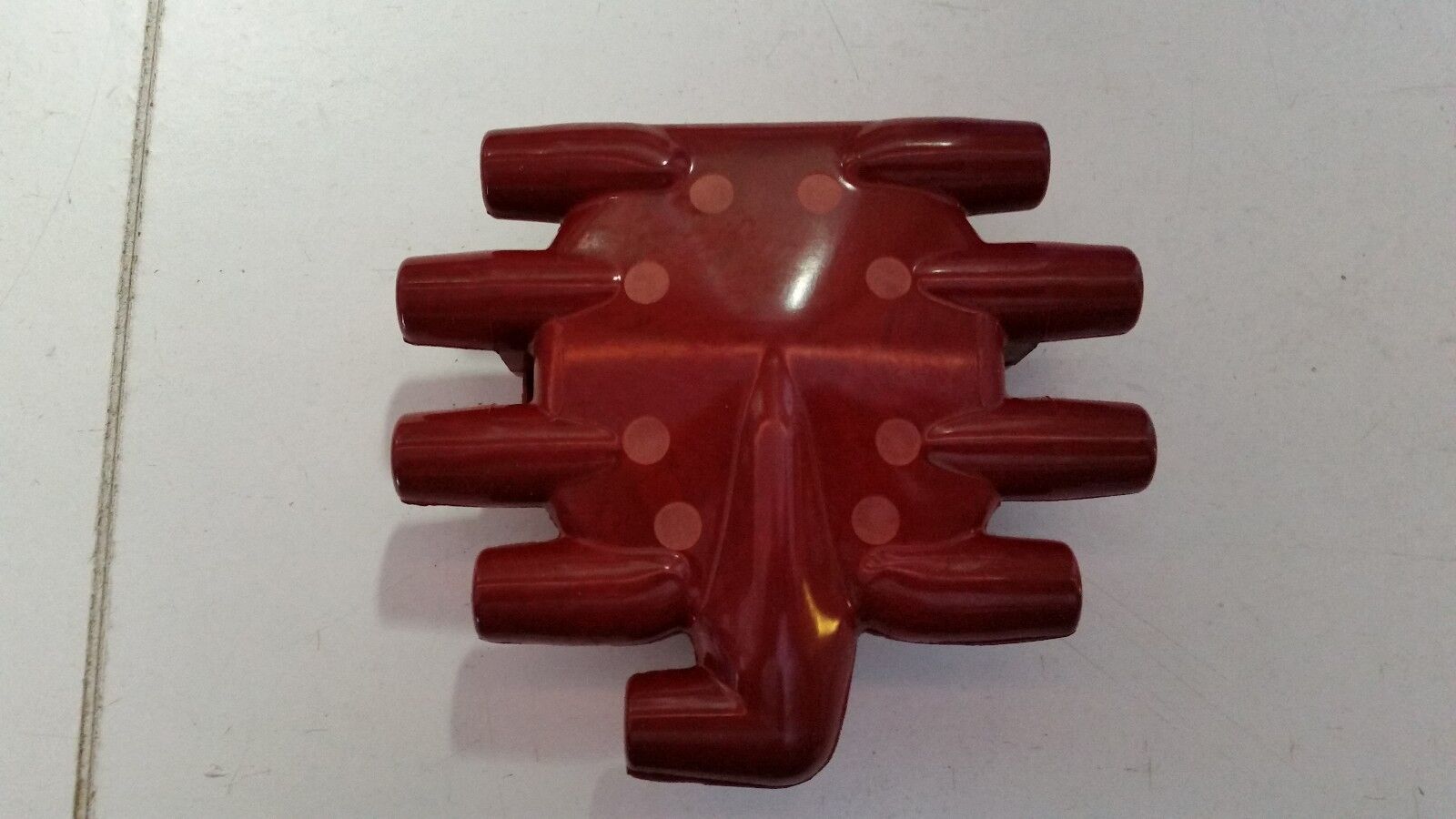

whats this distributor cap from?
goatman1
working on a messed up motor, i swore it was a 350 chev in a 1980ish bayliner
but googling says its from a ford 5.8l/351?
did volvo penta put a cap like this on a 350 or 305 chev motor?

so i was looking for a wiring diagram based off the distributor to try and see what the heck the cylinder is
but now im wondering what this distributor is from
Top dead center rotor is pointing at cylinder 8 but its number 1 on the cap. Im used to pointing the rotor at cylinder 1 tdc. Have a new cap and wires in the boat so going to try them out and found another resistor in the shop
Doesn't matter where the rotor is pointing to on another part of the motor, it only matters that it points at number 1 post on the distributor cap when number 1 cylinder is at TDC
If it's a chevy then firing order is 1-8-4-3-6-5-7-2
the cap had a firing order of 12736845 on it but ya I did the chev order deleted that cylinder thing from the resistor and the coil he gave me was a msd blaster antivibration marine coil, only 0.7 ohms so I tossed it and grabbed a spare 1.5 ohm from my boat and got it running, oils milky so have to do a couple oil flushes now. Compression is fine 6&8 were 110, #1 was 120 and the rest were 115. His shifter hose looks like it will crumble if you touch it
