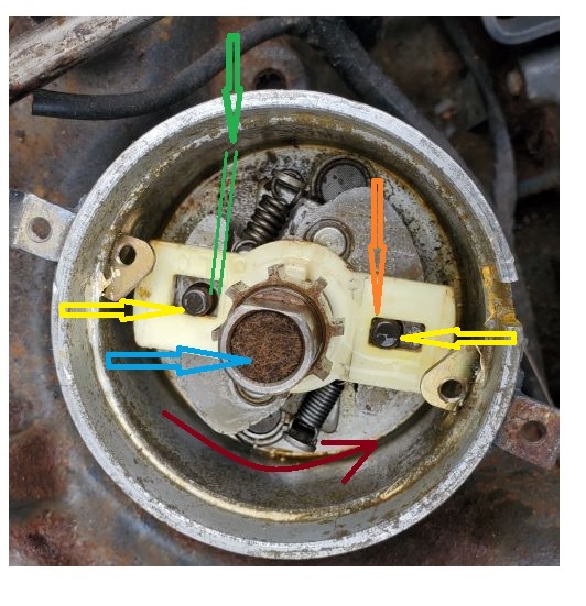

This may be a long shot here....... but take a look at the flyweight pins (yellow arrows) that glide within the plastic component.
These pins advance this component as centrifugal force operates the flyweights.
The slots in the plastic component control the Full In limit.
The pin at the left appears to lack complete retraction (shown by the remaining area via the green lines and arrow).
The pin at the right side appears to be completely retracted (shown by the orange arrow).
If I'm seeing this correctly, and if you were to set BASE advance while in this position, the centrifugal advance may be limited.
Keep in mind that every 1 degree of movement at this component equals 2 degrees crankshaft angle.
(Ignition advance refers to crankshaft angle)
In other words, if this part is not returning to BASE angle (by let's say 3 degrees), that equals 6 degrees at the crankshaft, or 6 degrees of advance that the system is NOT giving you.
But again..... a long shot!
Remove the felt (blue arrow) and see if there is a small C clip or snap ring that will allow you to remove the reluctor and plastic component.

Hopefully you will find something that is preventing the one flyweight from fully returning to BASE mode.

You make a good point about the advance not retracting all the way. I'll look under that felt for a clip and remove the reluctor see if something is interfering. What is that felt for? I did find new springs for $25 but I may not need them.
